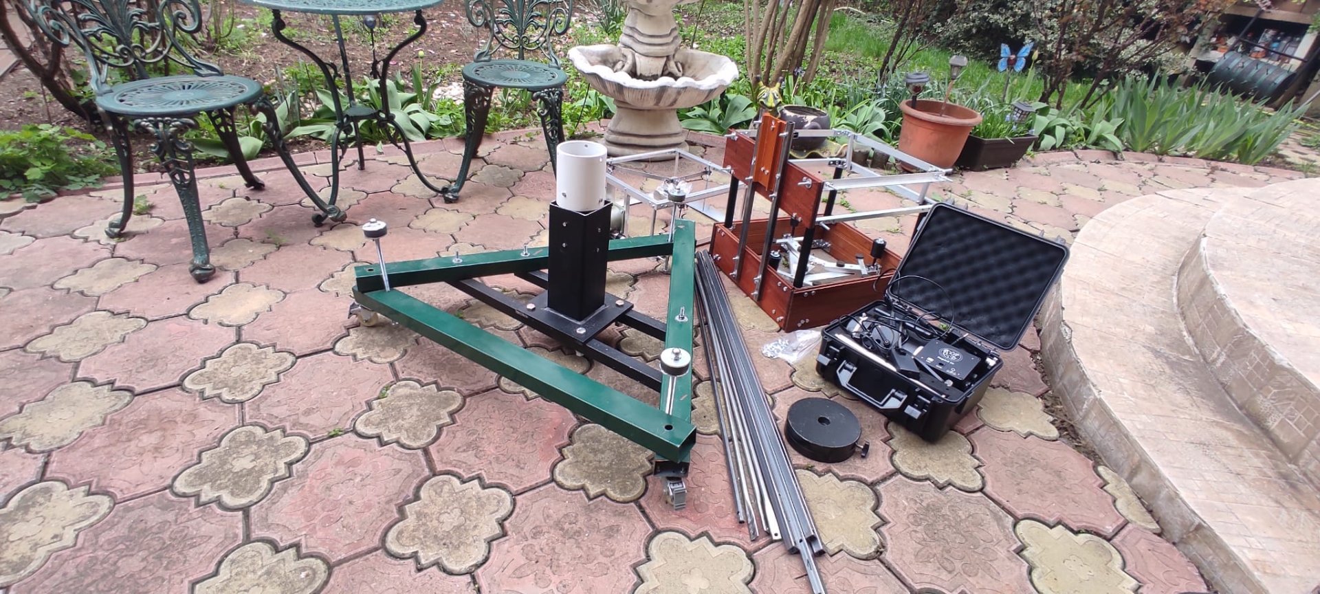

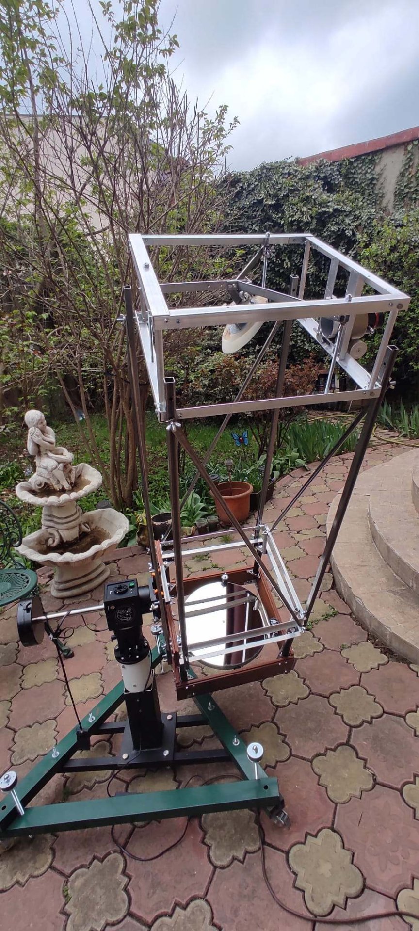

I have made some telescope sales in this forum for which I am very grateful therefore I think it is time to contribute myself to this community also.
I have of course aperture fever like many of us but my former 16" truss Dobson was too much for my back pain and I had also problems with finding targets and keeping the targets in the FoV at higher zoom levels.
Therefore I have sold the Dobson in January but then I had such great remorse that immediately I have bought a 14" F4 thin mirror (7 kg) and started the new project.
Now the telescope is somehow completed (but you know these are work in progress for many months to come) so I have made some initial test with it on a harmonic mount (Ragdoll 20).

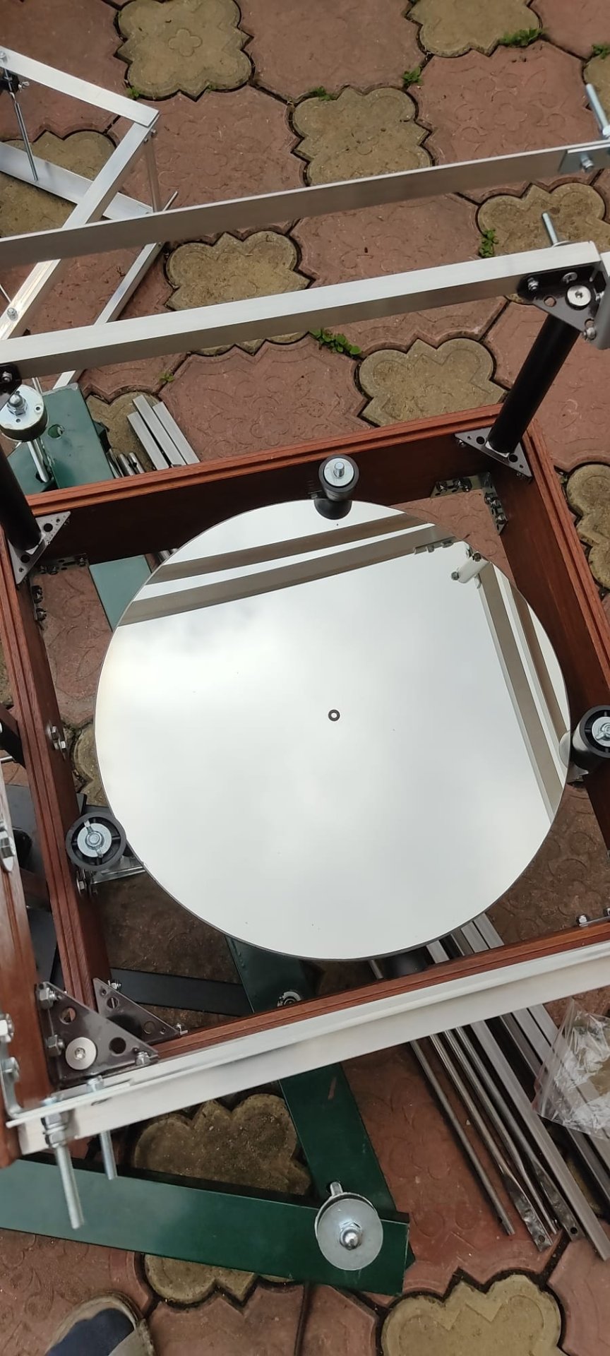

The truss Newton is split in several pieces so I can easily mount it in three steps: mirror base (7 Kg), mirror itself (7 Kg) and then the upper cage with fixing bars (6 Kg).
There are some vibrations (5-6 sec) after I focus the target but this is the pain when having such modular and lightweight truss long telescope.
The mount base is also custom made for minimal height at the ocular (160 cm from ground).
I am waiting now for first light but the weather is not very promising.
Next improvements will be to accommodate some light shields and maybe fans.
