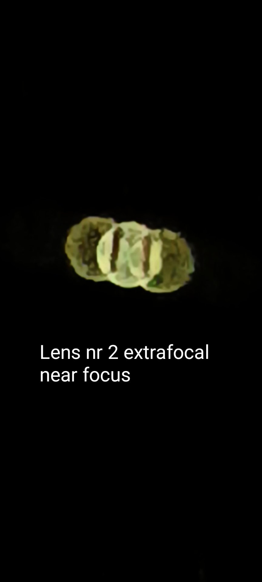

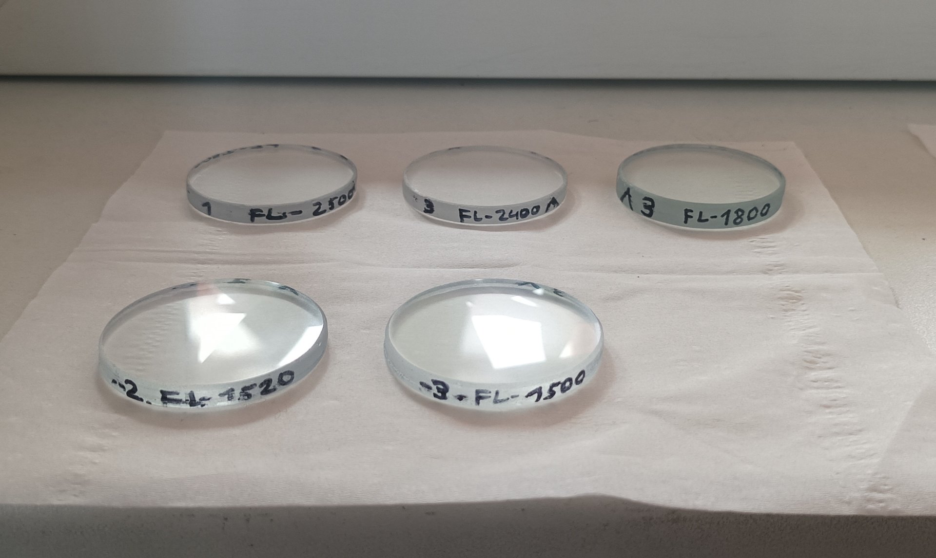

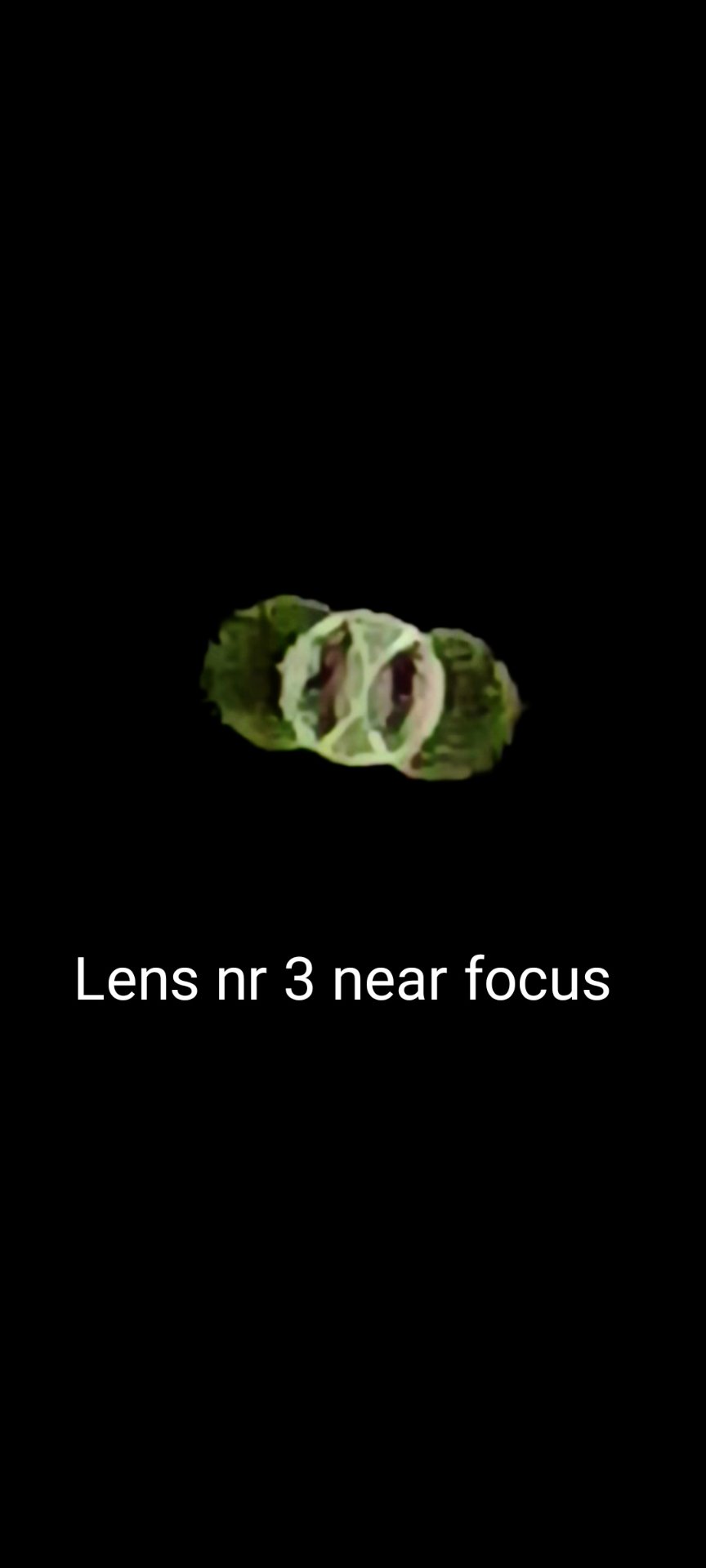

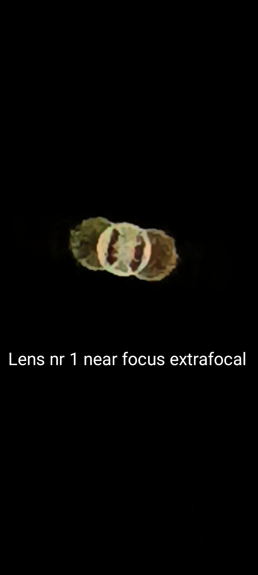

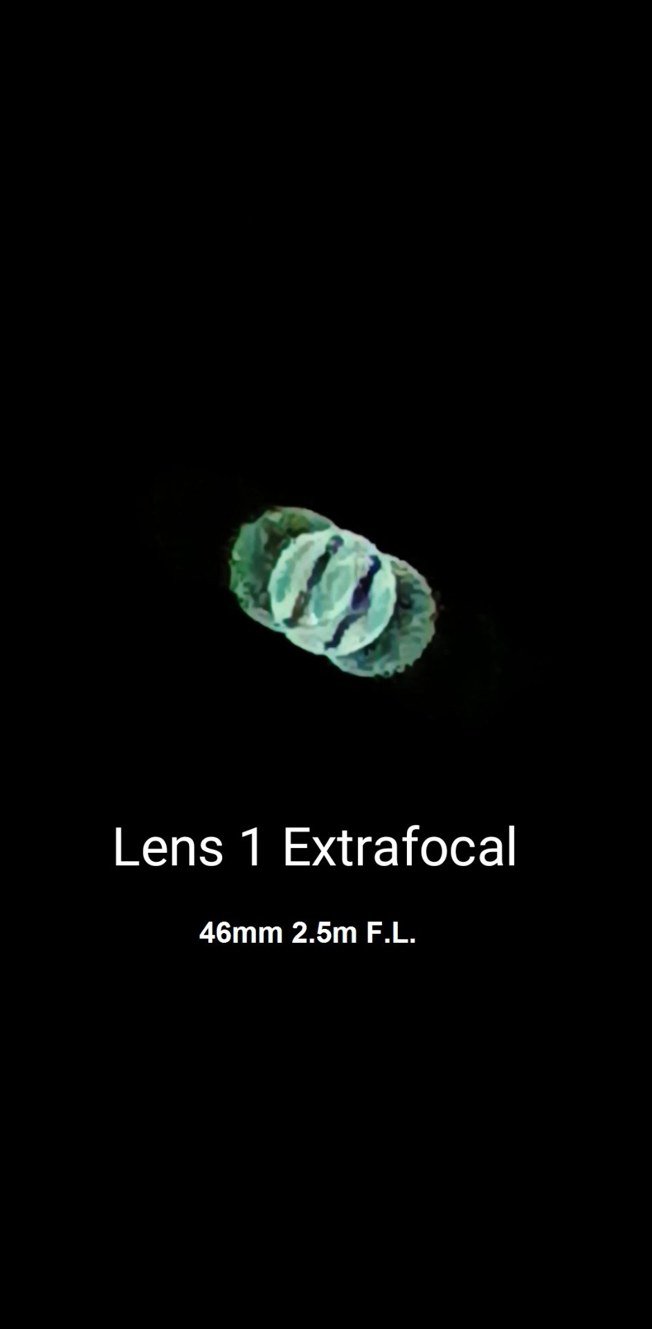

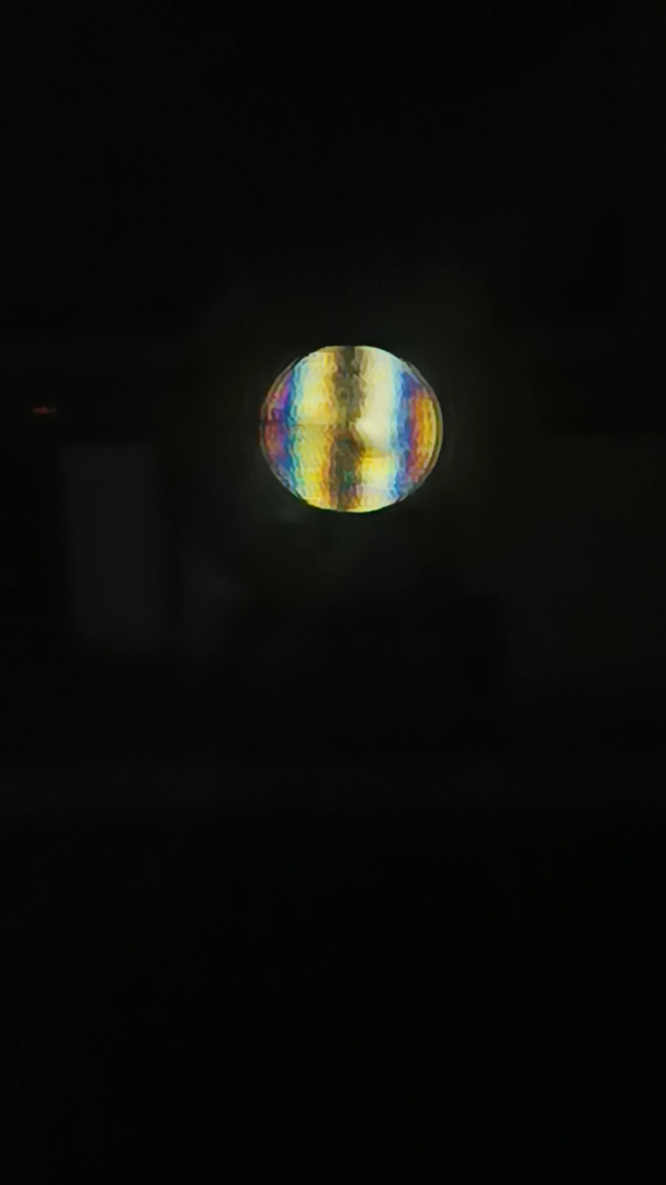

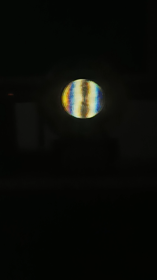

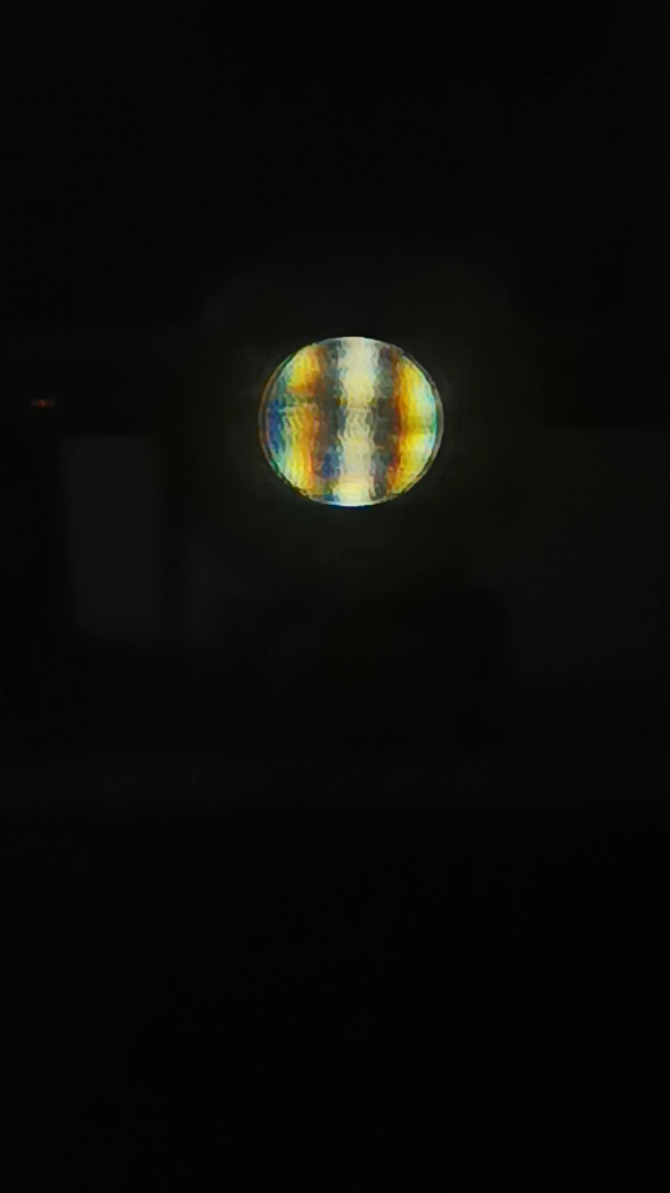

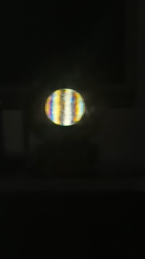

For sale are handmade, symmetrical biconvex single lenses. The price listed is per lens. These are suitable for building replicas of old telescopes.
The lenses were ground and polished using modern and traditional 17th-century manufacturing techniques. Each lens is unique, and its optical quality has been confirmed by individual testing. Although they function across the entire aperture, the sharpest images are obtained at the recommended usable diameter.

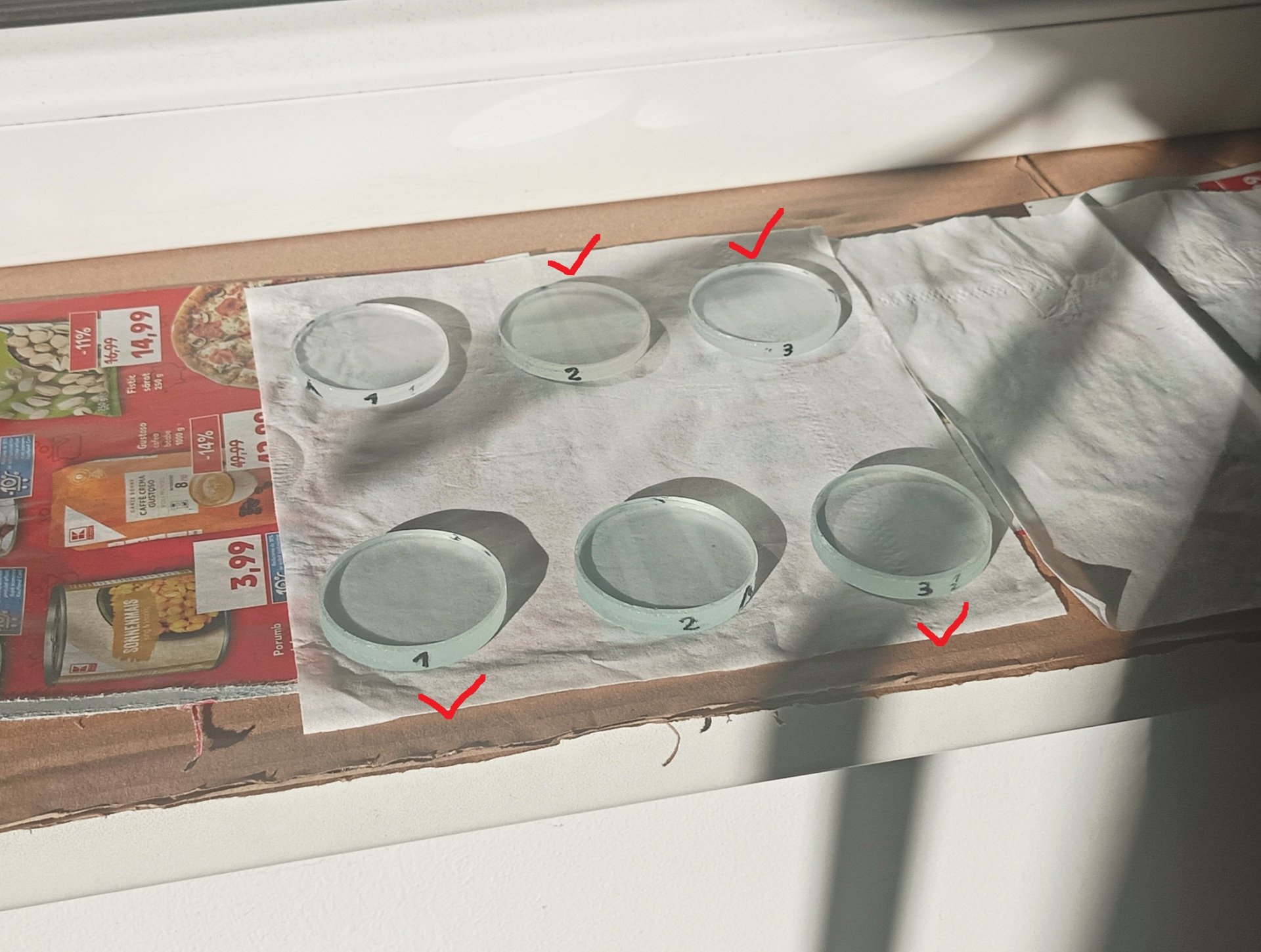

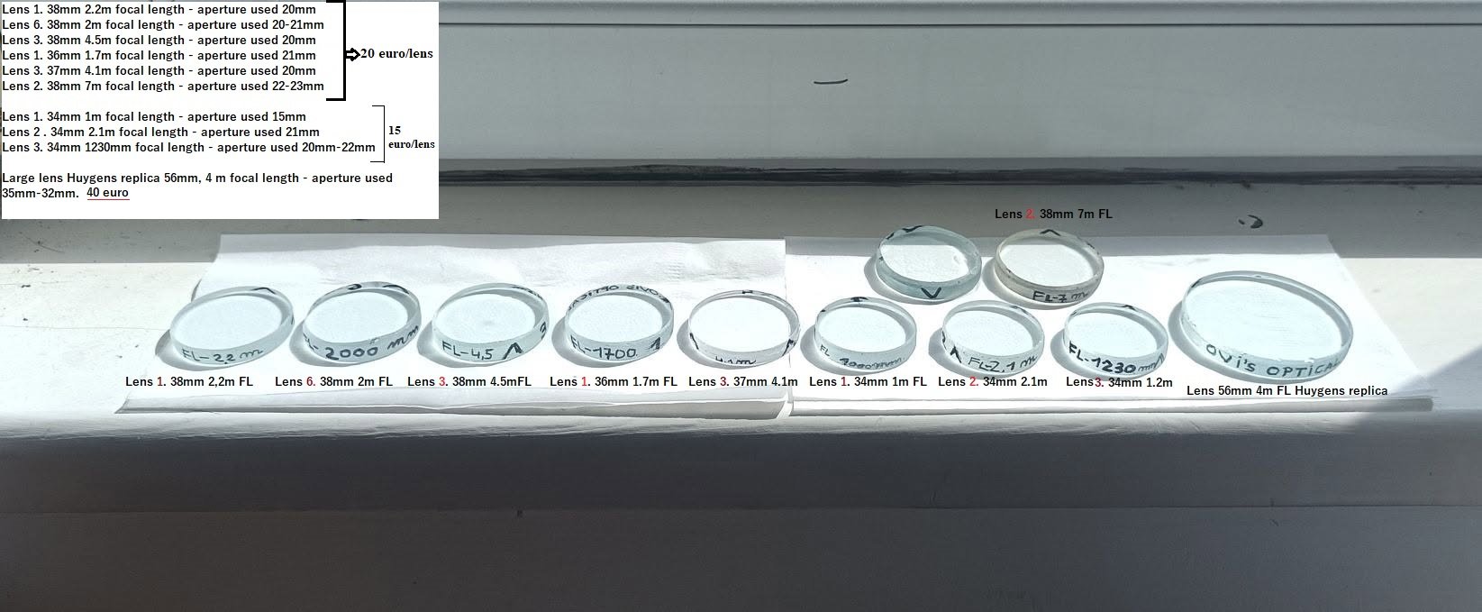

Set 1: Two lenses, D = 47 mm, focal length 2.4 m.
Edge thickness = 5.5 mm.
"White" soda-lime glass.
Usable diameter = 40 mm.
Price = 23 euros
Set 2: Two lenses, D = 47 mm, F = 3130 mm. This is the first set to be polished on paper.
Edge thickness = 7 mm.
"Green" soda-lime glass.
Price = 23 euros
Set 3: Lens only, D = 47 mm, F = 1800 mm.
Usable diameter = 35–34 mm.
Price = 23 euros

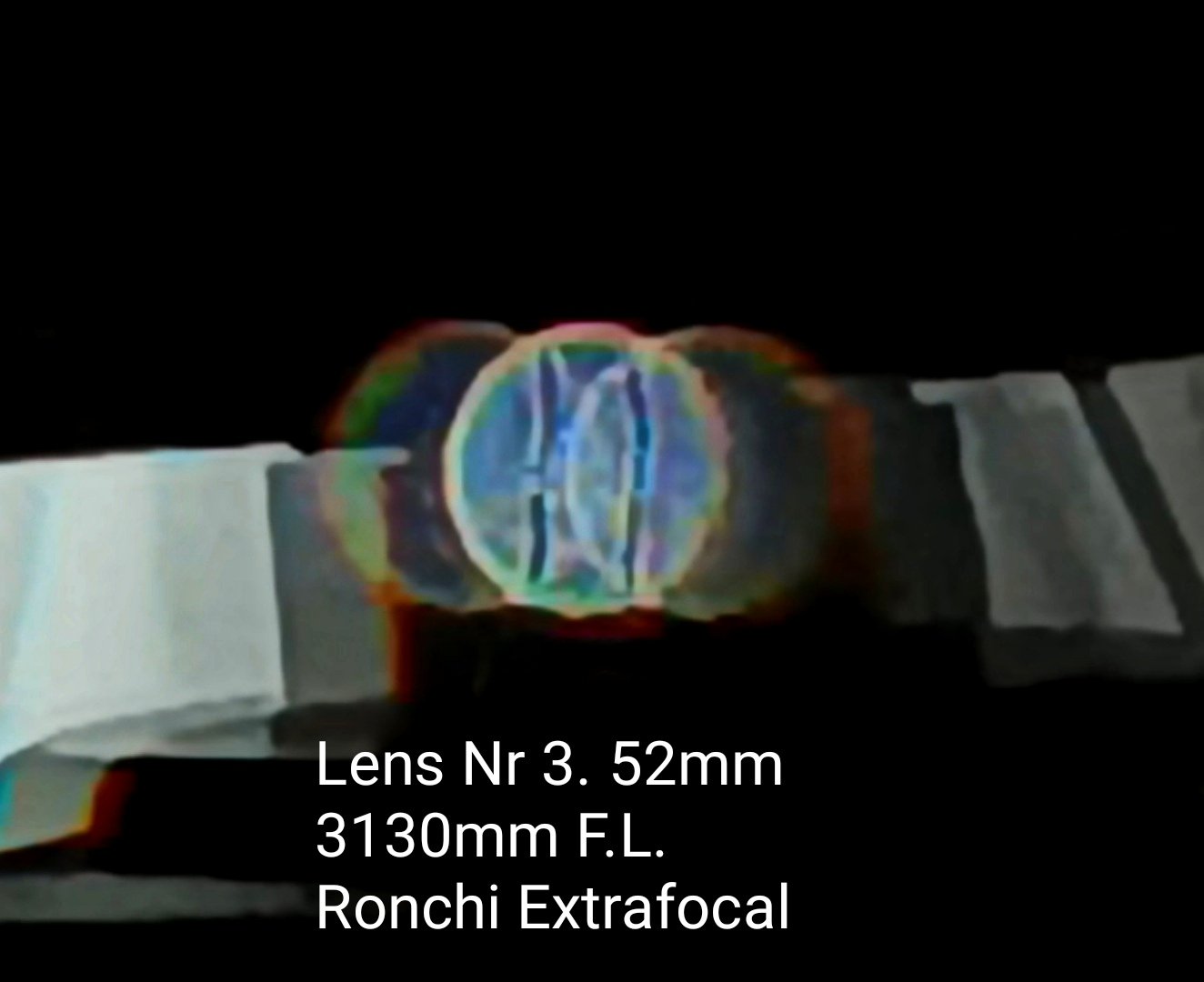

Set 4: Two lenses, D = 52 mm and F = 3200 mm, focal length 3130 mm.
Edge thickness = 5.6 mm.
"White" lime glass.
Usable diameter = 46 mm.
Price = 26 euros
Set 5: Two lenses, diameter = 47 mm, focal length = 1520 mm and 3130 mm.
Edge thickness = 5.4 mm.
"White" lime glass.
Usable diameter: 28 mm (1520 mm lens) and 31 mm (1500 mm lens).
Price = 10 Euros

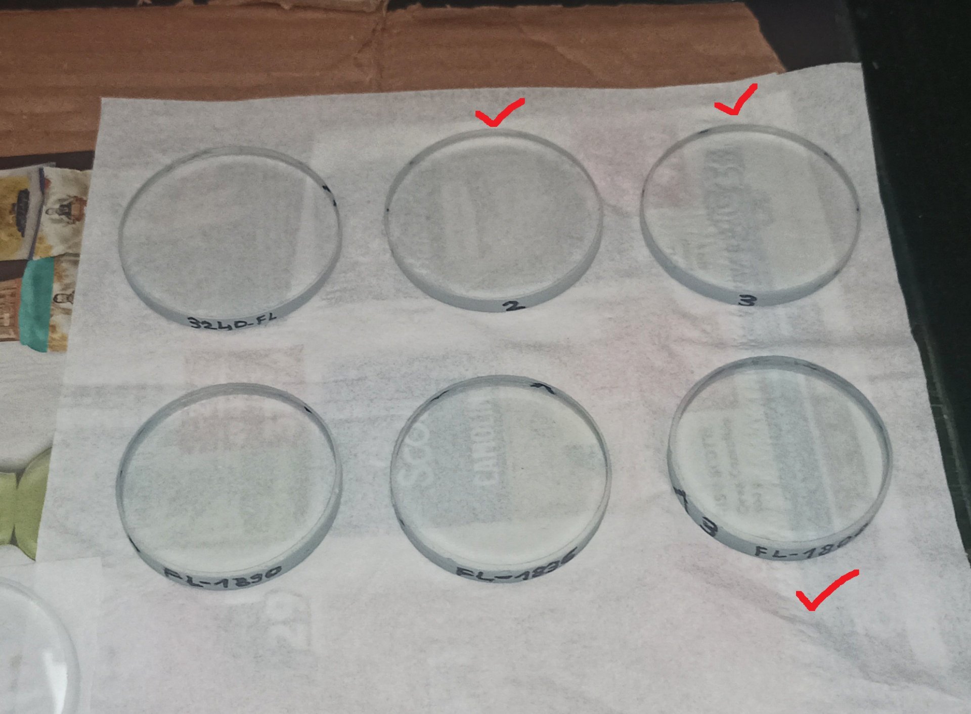

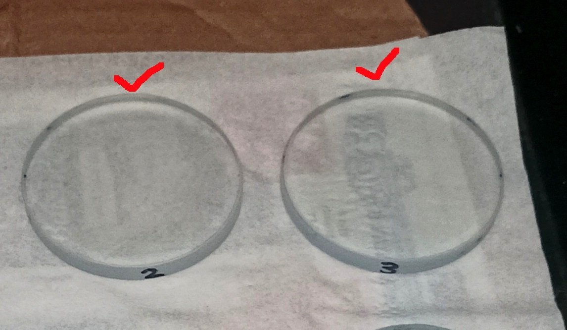

The lenses for sale are marked in red in the pictures.
