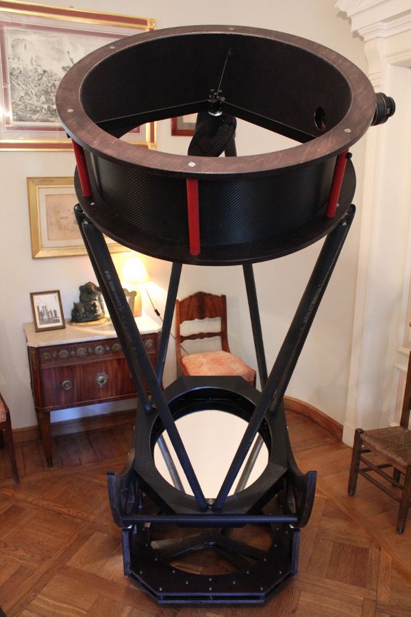

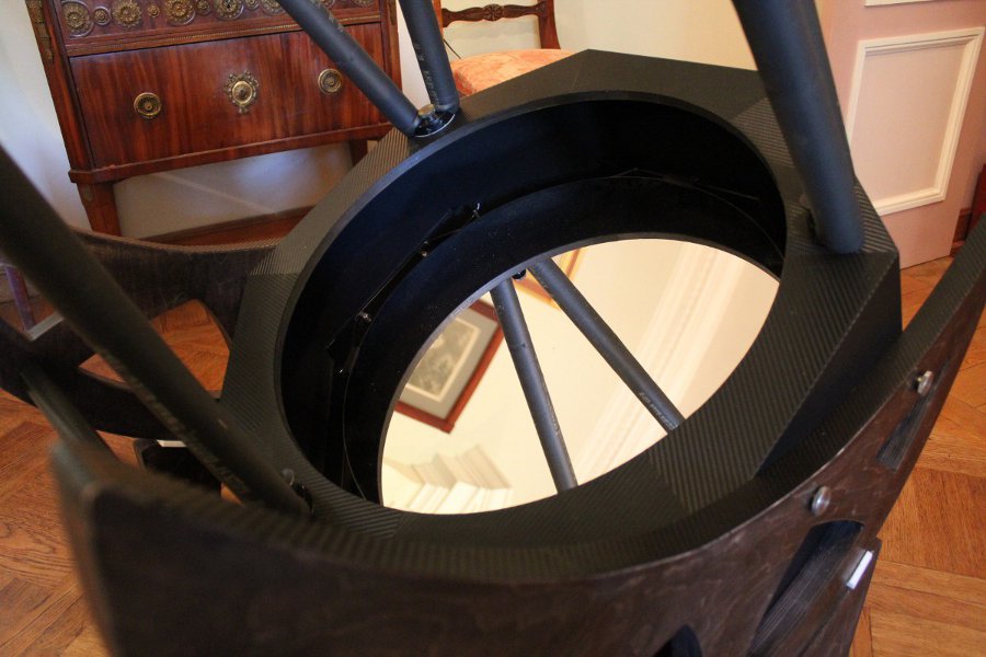

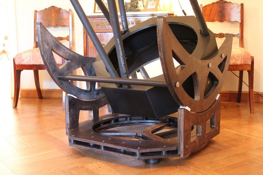

I'd like to show you the result of a couple of weeks of my work.
It's 22" F/3.7 truss dobsonian with custom made optics (lambda/9). It weights ca. 40-45kg and should fit 75x80x50cm cube + poles. Focuser in zenith position is on ca.2 meters.

wow! That looks REALLY GREAT. :respekt:
BTW: Where did you take the pictures? I guess it isn't your home, isn't it?
Cheers,
Achim
I made it on special order and the pisc were taken in owner father's home (an artist). Price was not adequate to the background ;)
The ends of the three spider vanes meet the three positions where his 6 truss-tube poles end. Also, maybe he simply likes 6 weaker spikes better than 4 brighte ones.
Regards, Martin
A bino with 30" mirrors would be VERY interesting! :D
Has anybody made something like this yet? (serious)
PS: really nice scope :)
