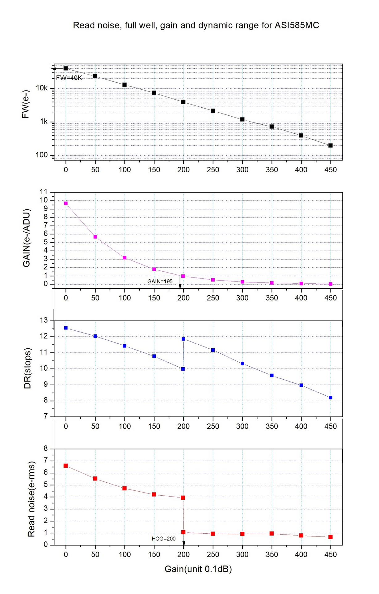

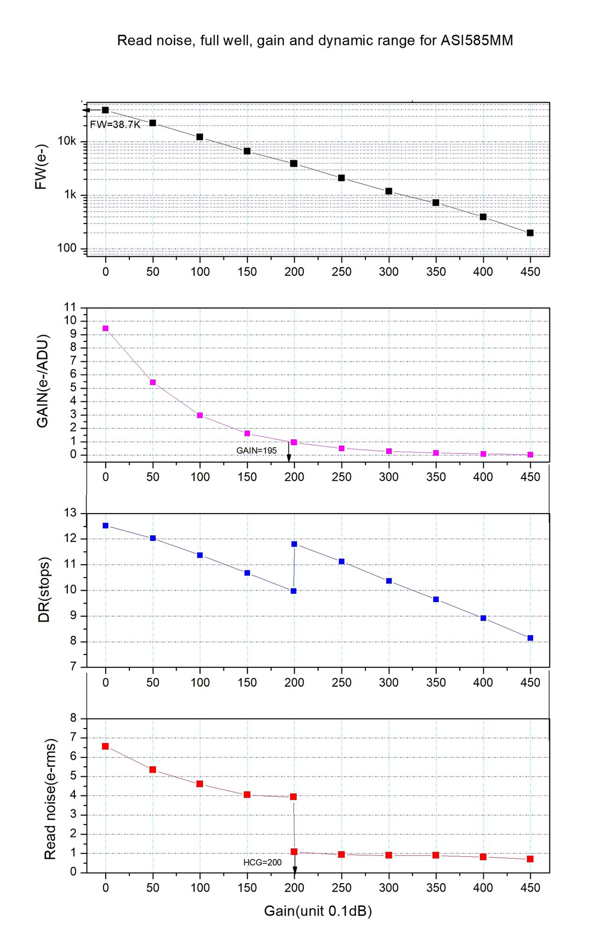

auf der ZWO-Seite ist es zwar noch nicht zu sehen, aber auf Facebook sind die News schon aufgetaucht. Dachte mir, ich teile das hier mal schnell mit euch, vielleicht ist es ja für den einen oder anderen spannend, was kommen wird.
Quelle: ZWO Astrophotography
ZWO ASI585 Series Camera HCG Mode Optimization Announcement
To further enhance the imaging performance of the ASI585 series and provide astrophotographers with an even better observing experience, ZWO’s R&D team has conducted extensive testing and precise optimizations. The HCG gain of the ASI585 series cameras has been adjusted to 200, allowing the cameras to maintain a wider dynamic range in HCG mode, reaching up to 12 stops.
This upgrade applies to five models: ASI585MM/MC, ASI585MM/MC Pro, and ASI585MC Air. After updating, you will need to re-shoot calibration frames to ensure proper stacking in post-processing.
We sincerely hope this optimization will further enhance your astrophotography journey. We look forward to seeing the stunning images captured with your upgraded ASI585 cameras—feel free to share your results and experiences on social media or in the AstroImg!
