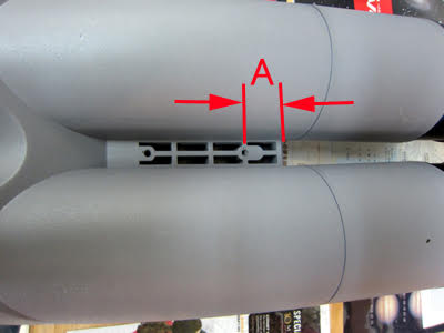

Hallo Markus,
ich habe Tatsuro gefragt, ob er es denn geschafft hat die Drehachse in den Schwerpunkt des Binos zu legen, hier seine Antwort:
Zitat von Tatruro:
No, it can not be perfectly set on the center of the gravity, because
the dent of the reverse side of the binocular is not deep enough.
The point is how close can we set the vertical axis to the real gravity
center. The real gravity center seems to be the bottom level of the
dent between the two tubes, see the attached image disregarding the red
mark.
Link zur Grafik: http://www.arsmachina.de/astro/rvsd.jpg
And I have succeeded in setting the vertical axis as close as only 15mm
below the real gravity center. And by intentionally shifting the v-axis
toward near side to some extent, the binocular will show the perfect
balance at 45deg to 70deg angle. That's my strategy and I believe it
worked.
And the special shaped clamp is so strong that you can set the frictions
as you like.
So, my Center Mount has not achieved the perfect gravity center all
through the angle, but I believe I have achieved the light-weight and
compact mount for APM100 BINOCULARS.
Also, der Schwerpunkt liegt ziemlich genau auf der Befestigungsebene.
Die Drehachse des Center Mount liegt 15mm unterhalb des Schwerpunktes.
Tatsuro hat die Achse aber auch vertikal etwas verschoben, dadurch ist das Glas zwischen 45° und 70° im Gleichgewicht.
