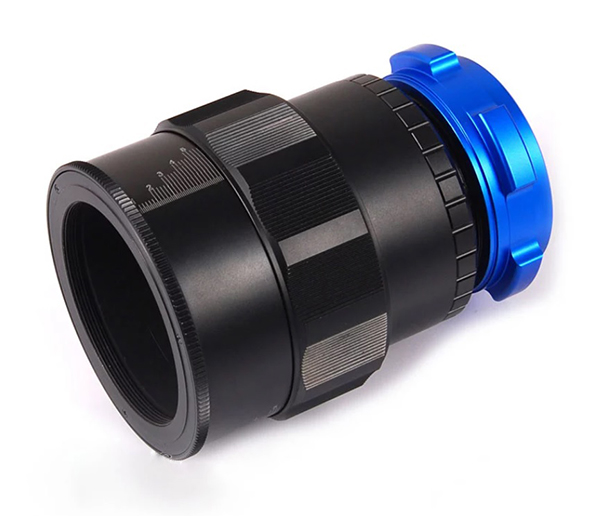

Was ist denn von diesem Produkt zu halten:
SCT to 2.5" Helical Focuser coaxial twist Lock Adapter S8161
Specifications:
Clear Aperture: 2.5"
Output interface: 2"
Input interface: SCT, M60*1
Focusing travel: 50MM
Focusing the shortest distance: 75mm
Focusing the longest distance: 125mm
Item weight: 430g, Weight with SCT: 470g
Credit: AliExpress
