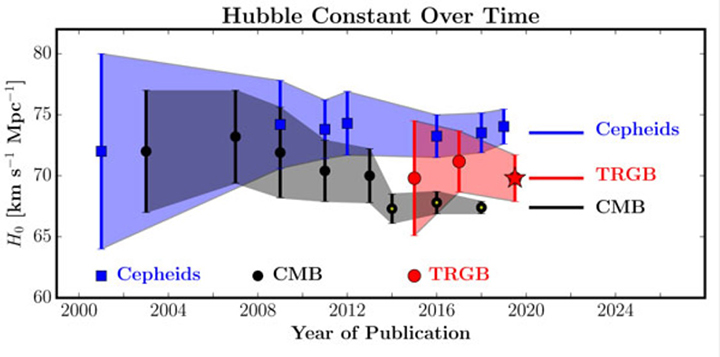

Diskrepanz in der Hubble Konstante
Noch ein neues Messergebnis:
New Hubble constant measurement adds to mystery of universe's expansion rate
Dabei wurden nicht Cepheiden, sondern Rote Riesensterne zur Kalibrierung verwendet. Wenn deren Energieproduktion aus dem Proton-Proton Fusionsprozess erschöpft ist, kollabiert der Stern bis die damit einhergehende Aufheizung bei einer Kerntemperatur von 100 Millionen Kelvin explosionsartig die Fusion von Helium auslöst. Das Phänomen ist unter dem Namen Helium-Blitz bzw. Helium flash bekannt.
Siehe auch:
Tip of the red-giant branch / Spitze des Roten Riesenastes
Wendy L. Freedman et al. The Carnegie-Chicago Hubble Program. VIII. An Independent Determination of the Hubble Constant Based on the Tip of the Red Giant Branch *
∗ Based on observations made with the NASA/ESA Hubble Space Telescope
We present a new and independent determination of the local value of the Hubble constant based on a calibration of the Tip of the Red Giant Branch (TRGB) applied to Type Ia supernovae (SNe Ia). We find a value of H0 = 69.8 ± 0.8 (±1.1% stat) ± 1.7 (±2.4% sys) km s−1 Mpc−1 . The TRGB method is both precise and accurate, and is parallel to, but independent of the Cepheid distance scale. Our value sits midway in the range defined by the current Hubble tension. It agrees at the 1.2σ level with that of the Planck Collaboration et al. (2018) estimate, and at the 1.7σ level with the HST SHoES measurement of H0 based on the Cepheid distance scale.
NASA/Hubble
111172
These galaxies are selected from a Hubble Space Telescope program to measure the expansion rate of the universe, called the Hubble constant. The value is calculated by comparing the galaxies' distances to the apparent rate of recession away from Earth (due to the relativistic effects of expanding space). By comparing the apparent brightnesses of the galaxies' red giant stars with nearby red giants, whose distances were measured with other methods, astronomers are able to determine how far away each of the host galaxies are. This is possible because red giants are reliable milepost markers because they all reach the same peak brightness in their late evolution. And, this can be used as a "standard candle" to calculate distance. Hubble's exquisite sharpness and sensitivity allowed for red giants to be found in the stellar halos of the host galaxies. The red giants were searched for in the halos of the galaxies. The center row shows Hubble's full field of view. The bottom row zooms even tighter into the Hubble fields. The red giants are identified by yellow circles.
Credits: NASA, ESA, W. Freedman (University of Chicago), ESO, and the Digitized Sky Survey
Jetzt auch bei Sky & Telescope: Tension Over Hubble Constant Continues
111674
Credit: W. Freedman et al. (Astrophysical Journal)
Conclusion by S&T: Ultimately, current measurements won’t settle the debate. Freedman and colleagues argue that to resolve the tension, astronomers must locally measure the Hubble constant to a precision better than 1%. That’s out of reach for now, but in just a couple years, the European Space Agency’s Gaia mission will be providing trustworthy and exquisitely precise distances to a heap of red giant stars, allowing a far better calibration than what is possible now. Perhaps then we’ll resolve the Hubble constant debate for once and for all.
L. Verde, T. Treu, A.G. Riess, Tensions between the Early and the Late Universe
"Discrepancies developing between observations at early and late cosmological time may require an expansion of the standard model, and may lead to the discovery of new physics. The workshop "Tensions between the Early and the Late Universe" was held at the Kavli Institute for Theoretical Physics on July 15-17 2019 [...] to evaluate increasing evidence for these discrepancies, primarily in the value of the Hubble constant as well as ideas recently proposed to explain this tension."

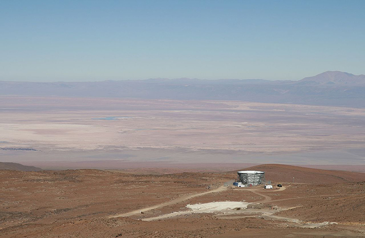

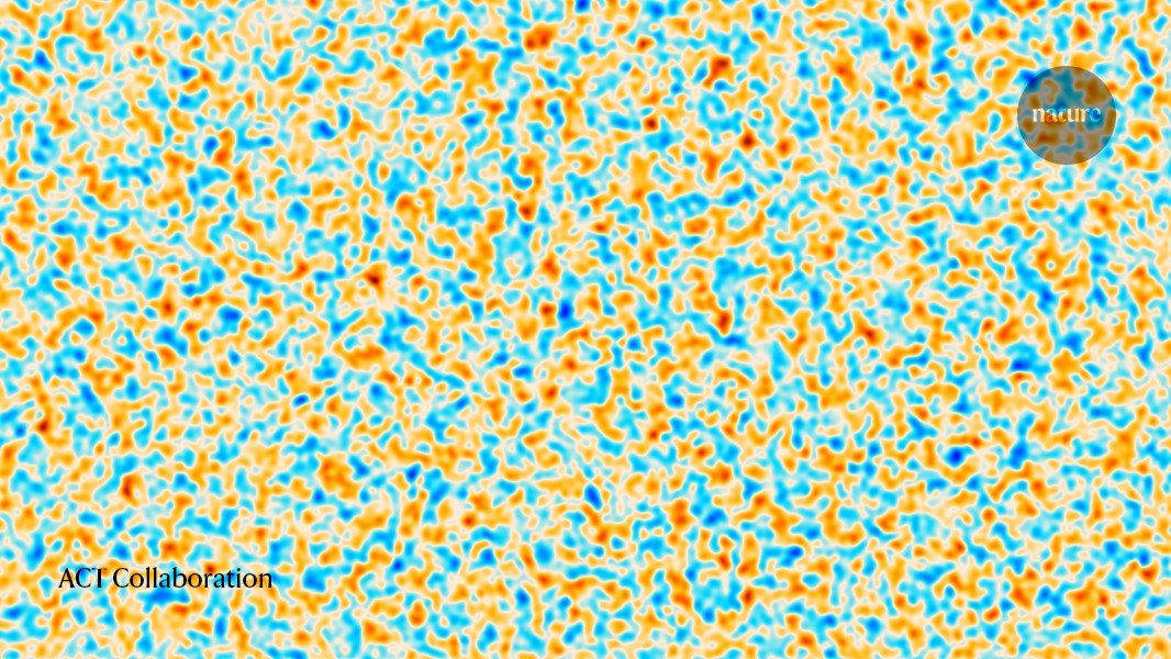

Es gibt neue Messergebnisse vom Atacama Cosmology Telescope, welche die Resultate vom Planck Satelliten insbesondere zur Hubble Konstante bestätigen.
S. Aiola et al. - THE ATACAMA COSMOLOGY TELESCOPE: DR4 MAPS AND COSMOLOGICAL PARAMETERS
We present new arcminute-resolution maps of the Cosmic Microwave Background temperature and polarization anisotropy from the Atacama Cosmology Telescope, using data taken from 2013–2016 at 98 and 150 GHz. The maps cover more than 17,000 deg² , the deepest 600 deg² with noise levels below 10µK–arcmin. We use the power spectrum derived from almost 6,000 deg² of these maps to constrain cosmology. From these one can derive the distance to the last-scattering surface and thus infer the local expansion rate, H0. By combining ACT data with large-scale information from WMAP we measure H0 = 67.6±1.1 km/s/Mpc, at 68% confidence, in excellent agreement with the independently measured Planck satellite estimate (from ACT alone we find H0 = 67.9±1.5 km/s/Mpc). The ΛCDM model provides a good fit to the ACT data, and we find no evidence for deviations ...
New research of oldest light confirms age of the universe
Credit: Wikipedia

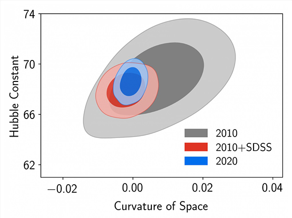

Und noch eine weitere unabhängige Messung der Hubble-Konstante im Einklang mit den CMB-Resultaten, diesmal aus dem gerade fertiggestellten riesigen Sloan Digital Sky Survey (SDSS) in seiner IV. Generation als "extended Baryon Oscillation Spectroscopic Survey (eBOSS)":
SDSS-IV eBOSS-SURVEY: Cosmological Implications
H0 = 68.20 ± 0.81 km/s/Mpc , remaining in tension with several direct determination methods; the BAO data allow Hubble constant estimates that are robust against the assumption of the cosmological model. In addition, the BAO data allow estimates of H0 that are independent of the CMB data, with similar central values and precision under a ΛCDM model.
No need to Mind the Gap: Astrophysicists fill in 11 billion years of our universe’s expansion history
Image credit: Eva-Maria Mueller (Oxford University) and the SDSS Collaboration
SDSS Home Page
Und das schreibt Sky & Telescope dazu:
New 3D-Map of the Universe - and a Growing Cosmological Debate
The massive amounts of data collected for the EBOSS project fills in part of a huge gap between observations of supernovae or variable stars in relatively nearby galaxies and the distant cosmic microwave background, emitted 13.4 billion years ago.
One of the most striking results from the EBOSS survey is a new measurement of the Hubble constant, a number that reveals how fast the universe is expanding now. This number has famously been the subject of debate ever since it was first measured; currently, most measurements of the early universe, such as the density fluctuations of the CMB, show the number to be on the lower side, while measurements in nearer galaxies give a higher number.
The EBOSS team is taking a side in the fight. Estimating a Hubble constant value between 67.4 and 69.0 km/s/Mpc, the team has results on the level of the measurements from the CMB.
“If people thought that after more data collecting the discrepancy would just disappear, that hasn’t happened,” says Adam Riess (Johns Hopkins University), who also was not involved in the study. “In fact, its significance has generally been growing.”
Riess and Freedman, who have both run studies based on stars in nearby galaxies, agree that the fact that the discrepancy persists strengthens the tensions between methods that use faraway light to sample the early universe and methods using nearby objects to sample later on in the cosmic timeline. “I think there is something interesting at play,” Riess muses.
“The baryon acoustic oscillation measurements are further important because they provide information on how the universe has evolved with time, and constraints on how, for example, the dark energy has evolved with time,” Freedman explains. Indeed, EBOSS measurements show that dark energy hasn’t changed a whit - which actually eliminates one possible explanation for the Hubble constant discrepancy.
Dark energy: map gives clue about what it is – but deepens dispute about the cosmic expansion rate
Using the Sloan Digital Sky Survey telescope, we measured more than 2 million galaxies and quasars - extremely bright and distant objects that are powered by black holes - over the last two decades. This new map covers around 11 billion years of cosmic history that was essentially unexplored, teaching us about dark energy like never before.
Our results show that about 69% of our universe's energy is dark energy. They also demonstrate, once again, that Einstein's simplest form of dark energy - the cosmological constant - agrees the most with our observations.
When combining the information from our map with other cosmological probes, such as the cosmic microwave background - the light left over from the big bang - they all seem to prefer the cosmological constant over more exotic explanations of dark energy.
Recent studies of the cosmic microwave background suggested that the geometry of space may be curved instead of being simply flat - which is consistent with the most accepted theory of the big bang. But our study concluded that space is indeed flat.
