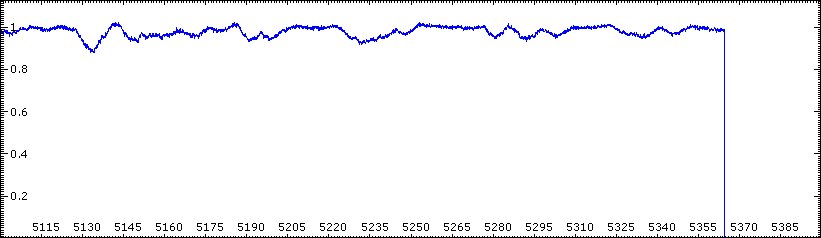

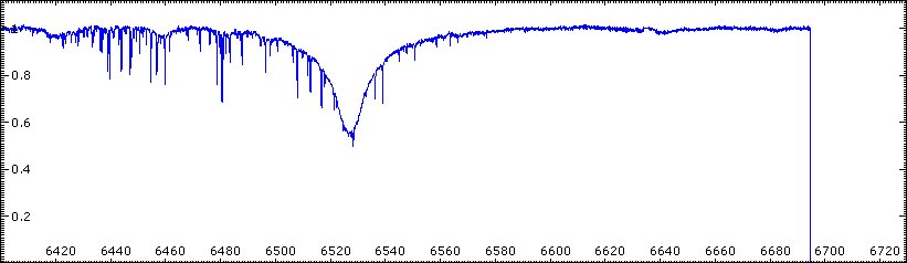

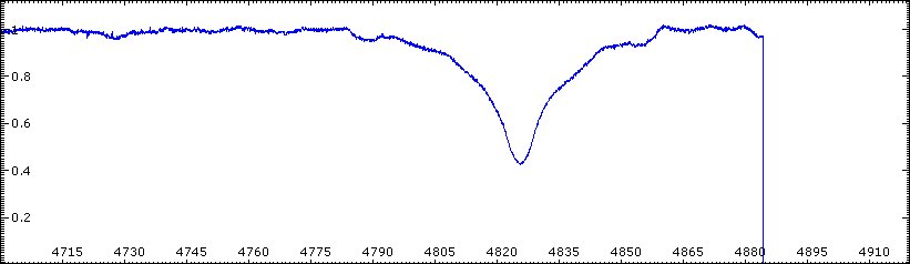

As the system does not have spectral lines in emission, the H-alpha
region seems to be a good candidate for the monitoring. However as the
primary rotates rapidly, the lines are broad. Therefore, echelle
spectra would work better, as they contain more lines. I found a
spectrum of Alpha Oph in the Elodie archive and normalized a few parts
to the continuum for you to see what to expect (three parts attached).

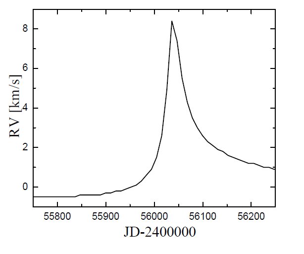

However, there is a challenge in detecting the radial velocity
variations as the total amplitude of the primary's radial velocity is
going to be only about 10 km/s (if I calculated it correctly). I used
orbital elements from a recent paper by Hinkley et al. 2011;
http://adsabs.harvard.edu/abs/2011ApJ...726..104H. My prediction for
the radial velocity curve is attached (AlpOph_RV.pdf). It assumes a
zero systemic velocity.
