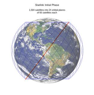

As of November 2019, SpaceX has deployed 122 satellites. They plan to deploy 60 more per launch, at a rate of one launch every two weeks beginning in November 2019. In total, nearly 12,000 satellites will be deployed by the mid-2020s, with a possible later extension to 42,000.[7]The initial 12,000 satellites are planned to orbit in three orbital shells: first placing approximately 1,600 in a 550-kilometer (340 mi)-altitude shell, then approximately 2,800 Ku- and Ka-band spectrum satellites at 1,150 km (710 mi) and approximately 7,500 V-band satellites at 340 km (210 mi).[8]Commercial operation could begin in 2020.[9]
