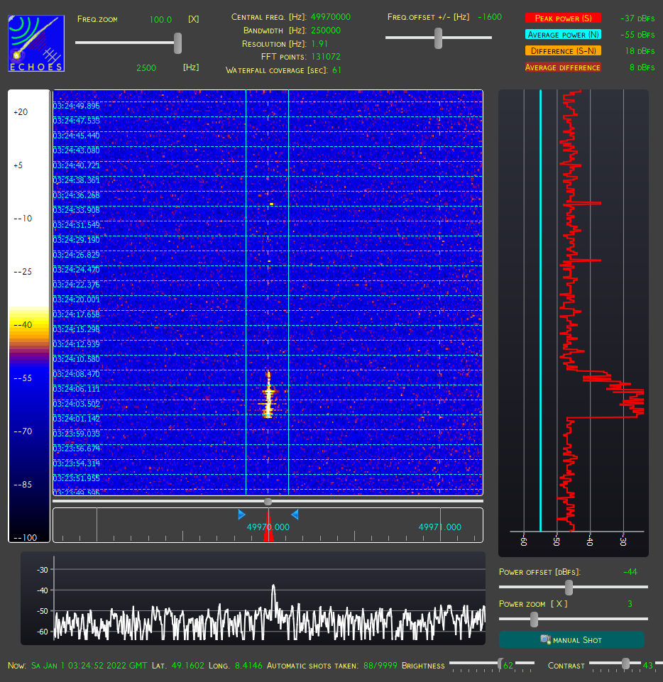

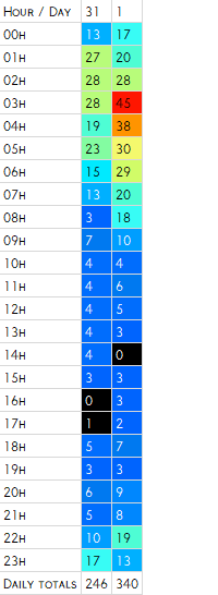

Guten Morgen,
Links die Meteörs gesamt und rechts die länger als 1 Sekunde, wobei wir gestern zwischen 19:00 und 19:30 Uhr UT einen Stromausfall hatten. Die Gegend war dunkel.
Am 31. 12. gab es 4 Events mit einen S-N Wert über 30 und am 1.1. deren 8.

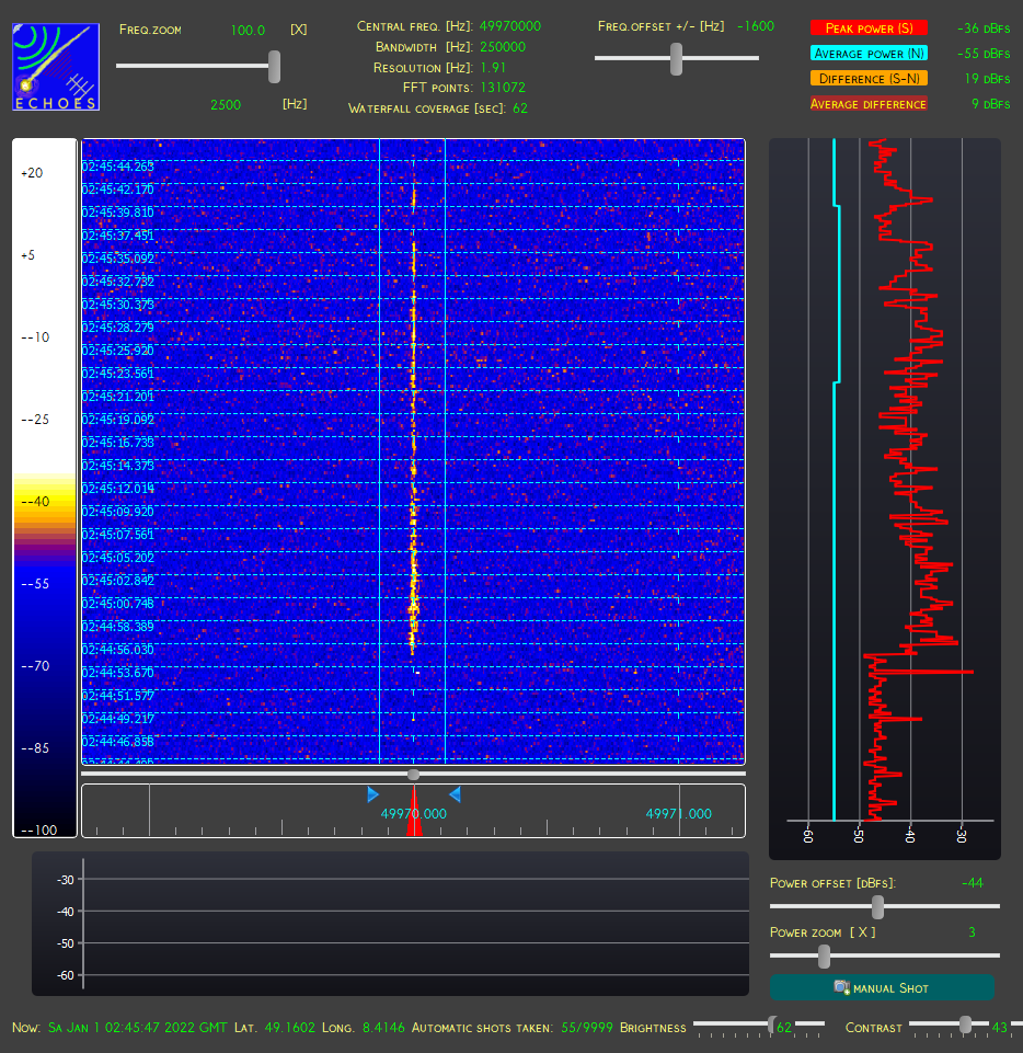

Event nr.
55​
Date
01/01/2022
UTC time
02:45:07.561
Unix timestamp (seconds since 01/01/1970)
1641005107.983
Tune [Hz]
49971600
Bandwidth [Hz]
250000
Central frequency [Hz]
49970000
Lowest frequency displayed[Hz]
49968750
Highest frequency displayed[Hz]
49971250
Zoomed bandwidth displayed[Hz]
2500
Resolution step [Hz]
1,90735
Threshold behavior
automatic​
Upper threshold [%]
65​
Lower threshold [%]
45​
Upper threshold [dBfs]
15,307​
Lower threshold [dBfs]
13,4516
Range from [Hz]
49969875
to [Hz]
49970125
Event state
Raising front​
Event peak
Falling front
Maximum peak (S) [dBfs]
-39,6251
-31,2636
-42,1039
Average peak [dBfs]
-46,5337
-44,9086
-38,256
Noise (N) [dBfs]
-55,6136
-55,5762
-55,3869
(S-N) [dBfs]
15,9885
24,3126
13,283
Average(S-N) [dBfs]
9,07983​
10,6676​
17,1309​
Maximum peak frequency [Hz]
49969995
49969993
49970001
Standard deviation
0,189085
0,240087
0,200045
Lasting [mS]
982
12577
Frequency shift [Hz]
-1​
Area covered by echo[FFT points]
322​
Area interval [FFT points]
6419​
Total number of peaks
47​
LOS Speed [m/s]
-5​

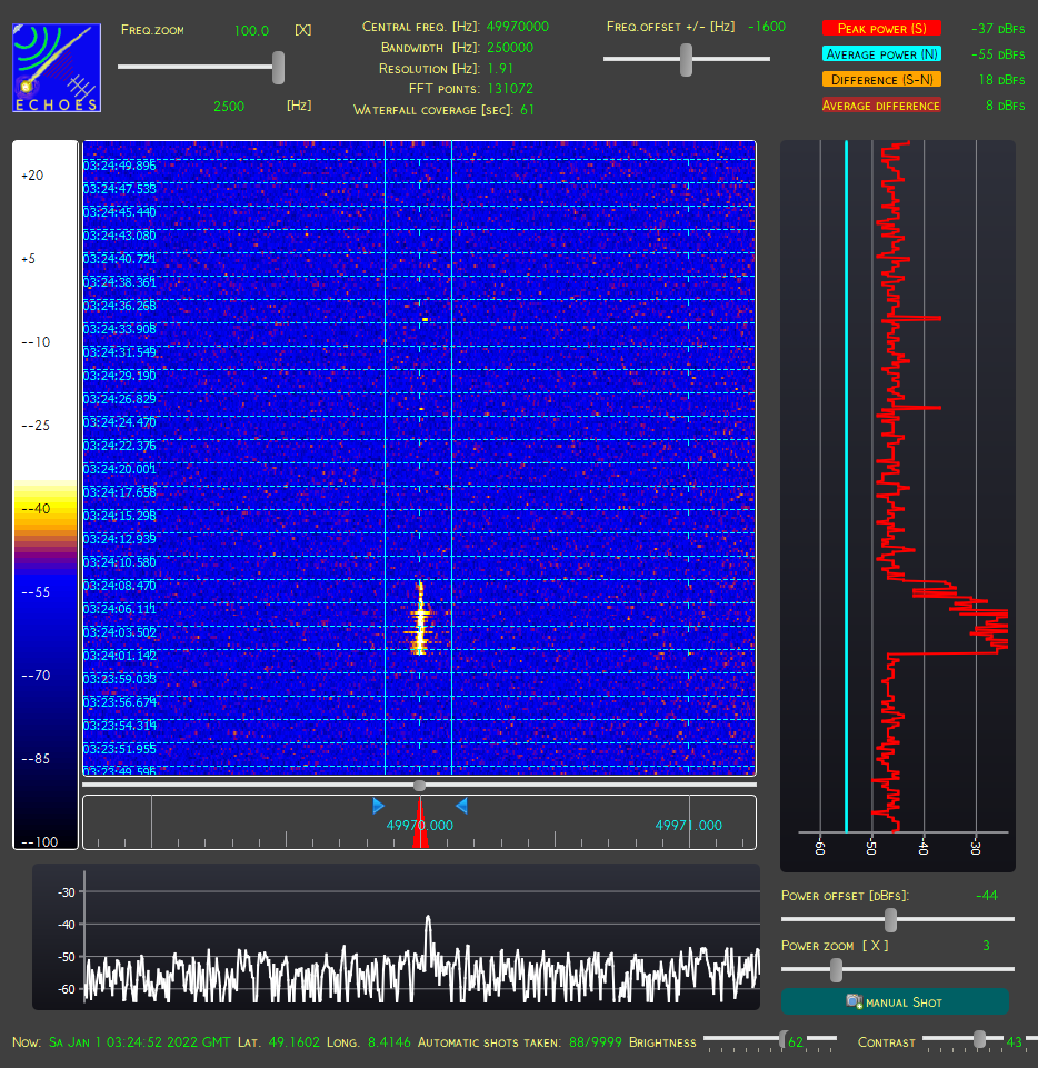

Event nr.
88​
Date
01/01/2022
UTC time
03:24:08.220
1641007448.595
Tune [Hz]
49971600
Bandwidth [Hz]
250000
49970000
49968750
49971250
2500
1,90735
Threshold behavior
automatic​
Upper threshold [%]
65​
Lower threshold [%]
45​
14,0012​
12,3041
Range from [Hz]
49969875
to [Hz]
49970125
Event state
Raising front​
Event peak
Falling front
-26,3529
-18,792
-44,8446
Average peak [dBfs]
-47,0643
-41,4304
-31,9366
Noise (N) [dBfs]
-55,5069
-55,3622
-55,2794
(S-N) [dBfs]
29,154
36,5702
10,4347
Average(S-N) [dBfs]
8,44255​
13,9319​
23,3428​
49970005
49970003
49970005
Standard deviation
0,303077
0,399114
0,188411
Lasting [mS]
1092
7327
-5​
403​
3799​
30​
LOS Speed [m/s]
-29​

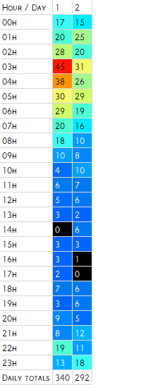

Laut Spaceweather sollen die Quadratischen morgen um 20:40 UT ihren Peak erreichen.
Hier gibt es auch Informationen: Quadrantiden 2022 - Infos & Geschichte
Alles Gute und vor allem Gesundheit im neuen Jahr Thomas

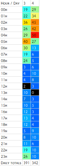

Guten Morgen,
Am 4.1. ist der Wasserfall von 13;25 bis 14:25 Uhr UT ausgefallen. Vielleicht hilft hier ein besserer Typ Antennenkabel.
Am 3.1. gab es 9 Events mit einen S-N lauter als 30 dBfs und am 4.1. deren 12.

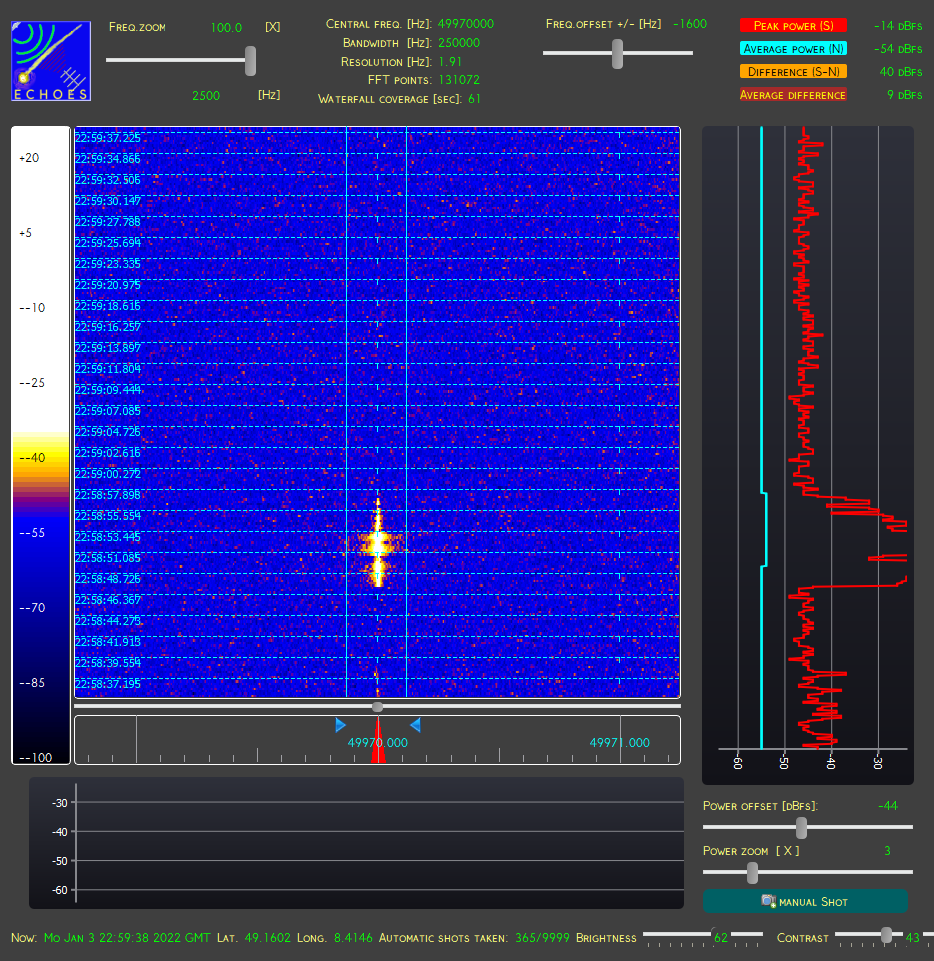

Event nr.
365​
Date
03/01/2022
UTC time
22:58:57.116
1641250737.523
Tune [Hz]
49971600
Bandwidth [Hz]
250000
49970000
49968750
49971250
2500
1,90735
Threshold behavior
automatic​
Upper threshold [%]
65​
Lower threshold [%]
45​
14,5417​
12,7791
Range from [Hz]
49969875
to [Hz]
49970125
Event state
Raising front​
Event peak
Falling front
-26,5666
-14,013
-43,9566
Average peak [dBfs]
-46,263
-24,8175
-29,4757
Noise (N) [dBfs]
-55,2453
-54,7828
-54,8985
(S-N) [dBfs]
28,6787
40,7697
10,9419
Average(S-N) [dBfs]
8,9823​
29,9653​
25,4228​
49970005
49970003
49970075
Standard deviation
0,278809
0,494145
0,191872
Lasting [mS]
3936
9733
-75​
762​
4978​
43​
LOS Speed [m/s]
-20​
Dieser hat mit einem S-N Wert von 40,77 dBfs gan schön Krach gemacht

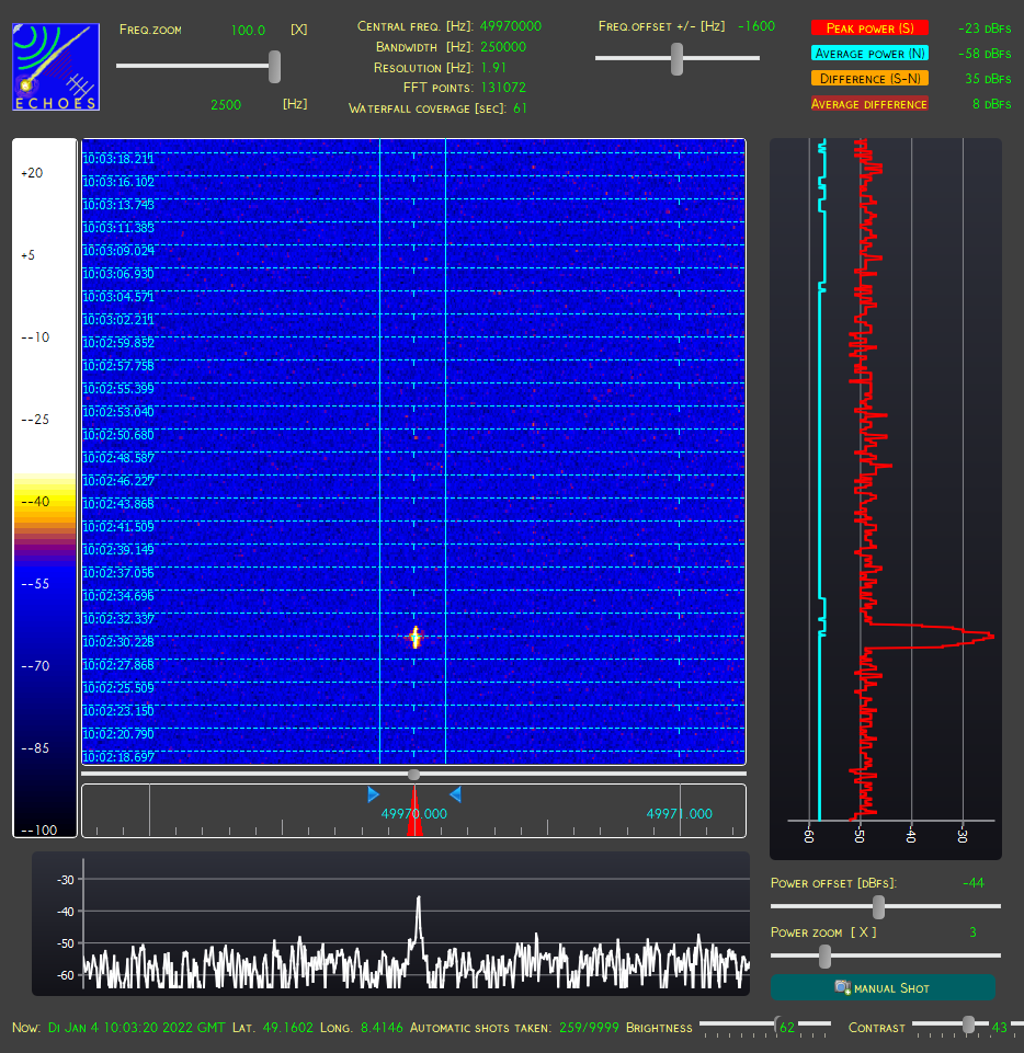

Dieser hat mit 50,09 Sekunden ein ganz schöne Bremsspur hingelegt.
Event nr.
259​
Date
04/01/2022
UTC time
10:02:31.274
1641290551.649
Tune [Hz]
49971600
Bandwidth [Hz]
250000
49970000
49968750
49971250
2500
1,90735
Threshold behavior
automatic​
Upper threshold [%]
65​
Lower threshold [%]
45​
14,6672​
12,8894
Range from [Hz]
49969875
to [Hz]
49970125
Event state
Raising front​
Event peak
Falling front
-34,3722
-23,0302
-48,6649
Average peak [dBfs]
-49,2968
-44,5056
-39,1346
Noise (N) [dBfs]
-58,2193
-58,047
-57,9482
(S-N) [dBfs]
23,8471
35,0168
9,28326
Average(S-N) [dBfs]
8,92251​
13,5414​
18,8136​
49970006
49970005
49970029
Standard deviation
0,249223
0,379329
0,156667
Lasting [mS]
983
2296
-29​
108​
1310​
10​
LOS Speed [m/s]
-2​
Dieser war gestern der lauteste.
Gruß Thomas

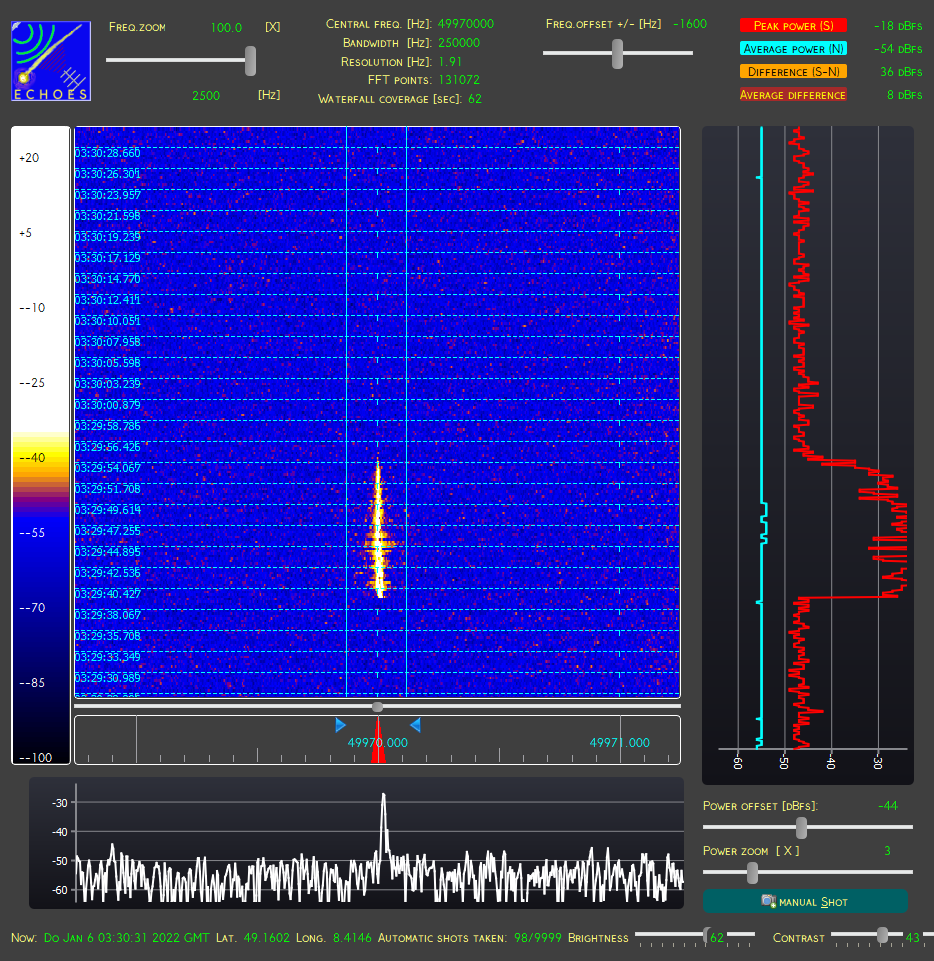

Guten Morgen,
Vorgestern gab es keinen und gestern 5 mit einem SN-Wert über 30 dBfs
Event nr.
98​
Date
06/01/2022
UTC time
03:29:54.848
1641439795.208
Tune [Hz]
49971600
Bandwidth [Hz]
250000
49970000
49968750
49971250
2500
1,90735
Threshold behavior
automatic​
Upper threshold [%]
65​
Lower threshold [%]
45​
14,4813​
12,726
Range from [Hz]
49969875
to [Hz]
49970125
Event state
Raising front​
Event peak
Falling front
-26,604
-18,1416
-46,5471
Average peak [dBfs]
-47,2306
-24,0199
-33,0954
Noise (N) [dBfs]
-55,9294
-54,946
-55,6336
(S-N) [dBfs]
29,3254
36,8044
9,08651
Average(S-N) [dBfs]
8,69881​
30,926​
22,5382​
49970014
49970003
49970083
Standard deviation
0,287125
0,40071
0,154618
Lasting [mS]
6015
15419
-83​
1067​
7860​
74​
LOS Speed [m/s]
17​
Gruß Thomas

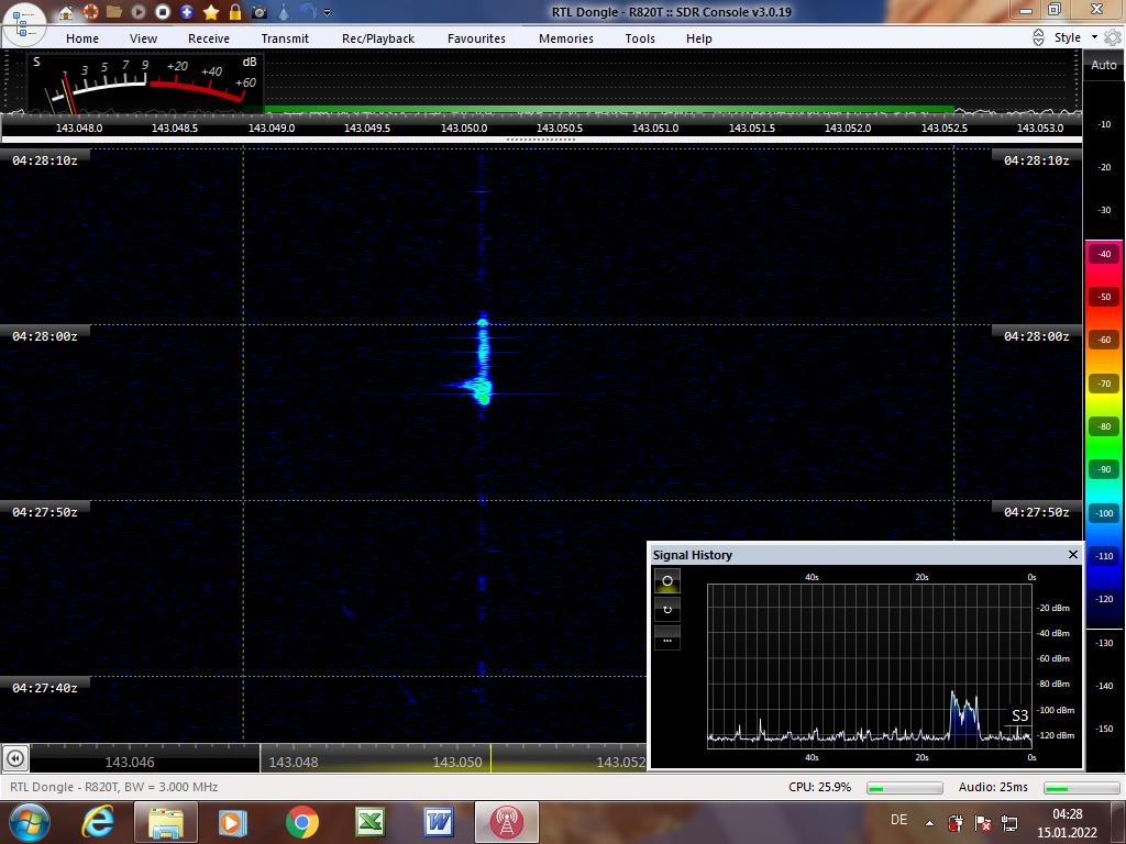

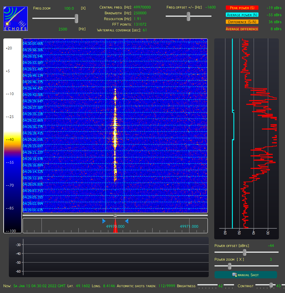

Guten Morgen,
Gestern 4:27 Uhr UT ist hier im Südwesten eine Feuerkugel gesichtet worden.
Event nr.
112​
Date
15/01/2022
UTC time
04:29:44.150
1642220984.525
Tune [Hz]
49971600
Bandwidth [Hz]
250000
49970000
49968750
49971250
2500
1,90735
Threshold behavior
automatic​
Upper threshold [%]
65​
Lower threshold [%]
45​
15,1456​
13,3098
Range from [Hz]
49969875
to [Hz]
49970125
Event state
Raising front​
Event peak
Falling front
-38,681
-19,4396
-46,4445
Average peak [dBfs]
-46,0514
-29,7996
-32,7886
Noise (N) [dBfs]
-55,5941
-55,0779
-55,1339
(S-N) [dBfs]
16,9131
35,6382
8,68937
Average(S-N) [dBfs]
9,54274​
25,2782​
22,3453​
49969991
49969999
49970026
Standard deviation
0,204578
0,38089
0,220454
Lasting [mS]
13889
33249
-26​
1327​
16768​
129​
LOS Speed [m/s]
15​
Und hier meine Daten.
Gruß Thomas
Hallo Thomas,
danke für die Info mit der Feuerkugel.
Zur fraglichen Uhrzeit hat meine Anlage dieses Signal geloggt.
LG Eberhard
meine Kamera hat wegen Hochnebels im Oberrheingraben nichts gesehen.
Wenn ich mir die Karte mit den einzelnen Kameras und deren Blickwinkel so betrachte, meine ich, dass der Einschlag in der Gegend von Schaffhausen erfolgte. Nur kann ich mir noch keine Reim über die Bewegungsrichtung machen.
Gruß Thomas

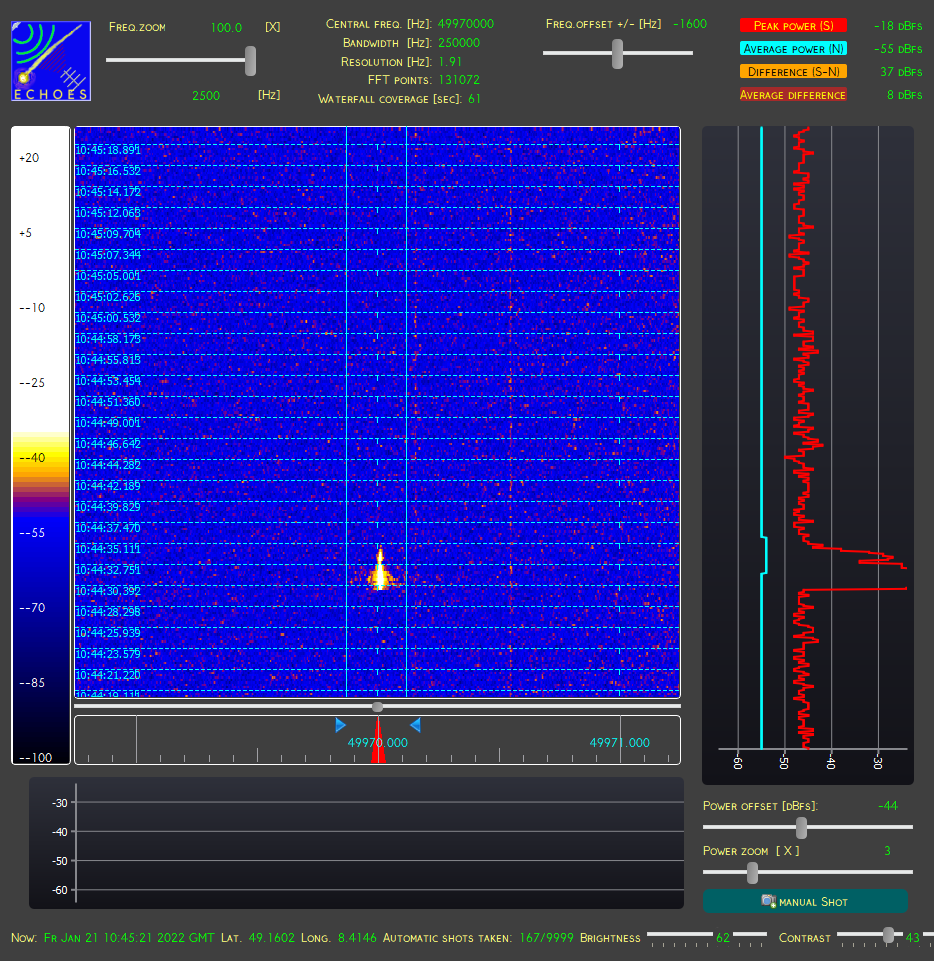

Vorgestern gab es 2 und gestern 4 Einschläge mit einem SN.Wert über 30 dBfs.
Event nr.
167​
Date
21/01/2022
UTC time
10:44:34.579
1642761875.017
Tune [Hz]
49971600
Bandwidth [Hz]
250000
49970000
49968750
49971250
2500
1,90735
Threshold behavior
automatic​
Upper threshold [%]
65​
Lower threshold [%]
45​
14,3814​
12,6382
Range from [Hz]
49969875
to [Hz]
49970125
Event state
Raising front​
Event peak
Falling front
-24,816
-18,206
-44,4475
Average peak [dBfs]
-46,859
-40,8485
-25,806
Noise (N) [dBfs]
-55,4049
-55,1781
-54,8017
(S-N) [dBfs]
30,5889
36,9721
10,3541
Average(S-N) [dBfs]
8,54592​
14,3296​
28,9956​
49970012
49970012
49970104
Standard deviation
0,294891
0,4212
0,182804
Lasting [mS]
982
4484
-104​
363​
2358​
22​
LOS Speed [m/s]
-22​
Gruß Thomas

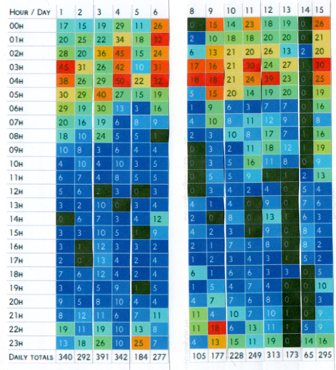

Guten Morgen Jörg,
hier das Colorgram der ersten 14 Tage
Der Datensatz vom 7. ist leider verloren gegangen. Am Rechner hab ich die Bilder nicht zusammen bekommen, also ausducken, ausschneiden , zusammenkleben und einscannen.
Die Ausfallzeiten sind wie folgt:
4.1. 13:25-14:25
11.1. 12:32-15:40
14.1. 17:44-22:34
17.1. 17:36-22:16
18.1. 17:25-
19.1. 6:08
Hier fällt auf: immer nachmittags. Merkwürdig.
Gruß Thomas

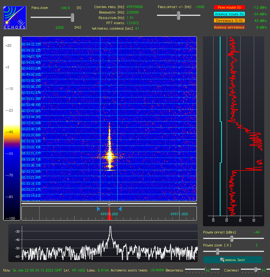

Guten Morgen,
Vorgestern gab es 7 und gestern 3 Einschläge mit einem SN-Wert über 30 dBfs.
Event nr.
19​
Date
22/01/2022
UTC time
00:53:41.030
1642812821.421
Tune [Hz]
49971600
Bandwidth [Hz]
250000
49970000
49968750
49971250
2500
1,90735
Threshold behavior
automatic​
Upper threshold [%]
65​
Lower threshold [%]
45​
14,8093​
13,0143
Range from [Hz]
49969875
to [Hz]
49970125
Event state
Raising front​
Event peak
Falling front
-15,2075
-12,2694
-42,86
Average peak [dBfs]
-46,1763
-21,9119
-34,5792
Noise (N) [dBfs]
-55,3313
-54,4278
-54,9504
(S-N) [dBfs]
40,1238
42,1584
12,0903
Average(S-N) [dBfs]
9,15495​
32,5159​
20,3711​
49970005
49970006
49970003
Standard deviation
0,469991
0,541935
0,186584
Lasting [mS]
5249
17063
-3​
1452​
8646​
89​
LOS Speed [m/s]
-17​
Der hier war mit 42 dBfs extrem laut. Bin mal gespannt, ob den irgend eine Kamera erfasst hat.
Gruß Thomas

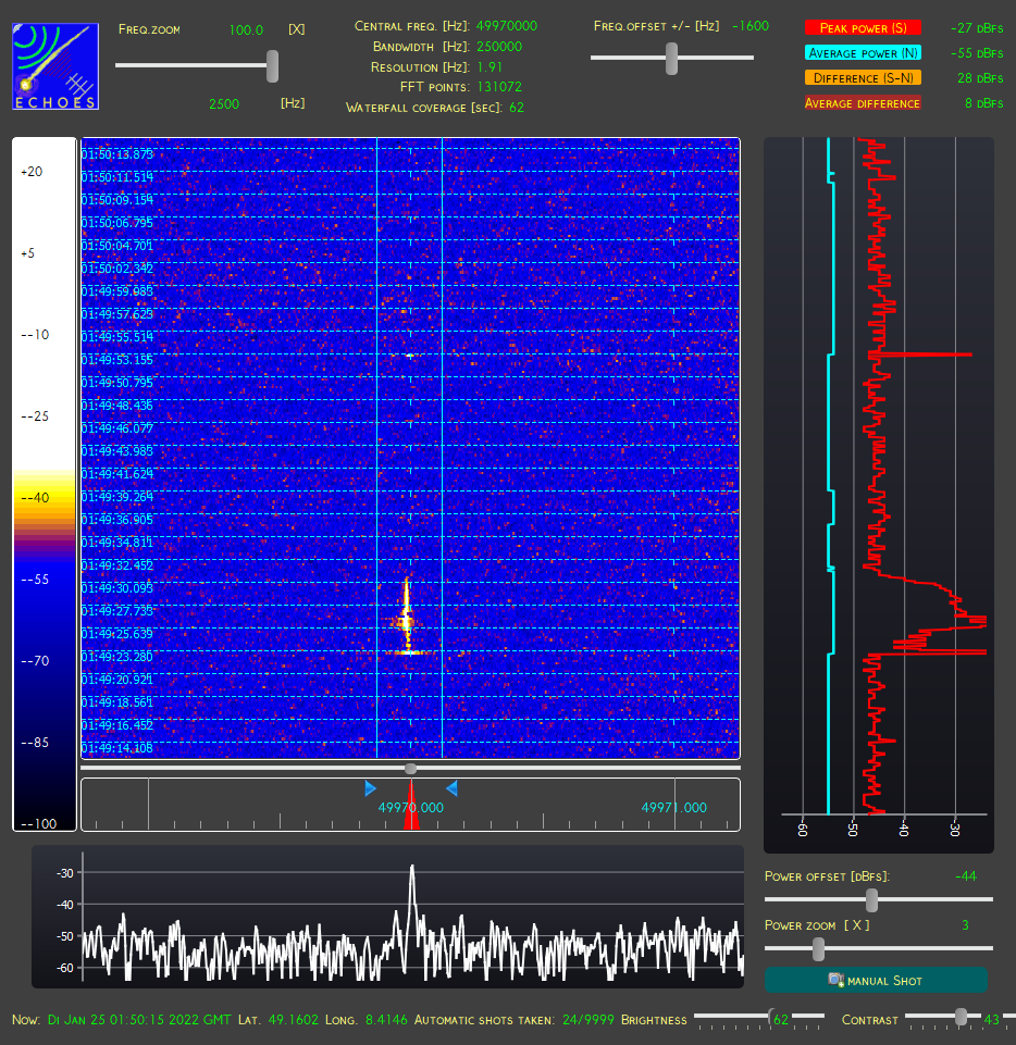

Guten Morgen,
Vorgestern und gestern gab es je 4 Events lauter als 30 dBfs
Event nr.
24​
Date
25/01/2022
UTC time
01:49:30.608
1643075371.030
Tune [Hz]
49971600
Bandwidth [Hz]
250000
49970000
49968750
49971250
2500
1,90735
Threshold behavior
automatic​
Upper threshold [%]
65​
Lower threshold [%]
45​
14,0099​
12,3117
Range from [Hz]
49969875
to [Hz]
49970125
Event state
Raising front​
Event peak
Falling front
-15,9008
-15,9008
-43,2613
Average peak [dBfs]
-46,5628
-46,5628
-31,5363
Noise (N) [dBfs]
-54,9918
-54,9918
-54,8821
(S-N) [dBfs]
39,091
39,091
11,6208
Average(S-N) [dBfs]
8,42892​
8,42892​
23,3458​
49969993
49969993
49969985
Standard deviation
0,438517
0,438517
0,170783
Lasting [mS]
7659
15​
267​
3930​
30​
LOS Speed [m/s]
4​
Der hier war der lauteste Kracher
Gruß Thomas

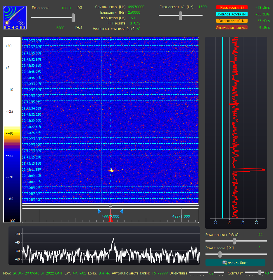

Guten Morgen,
Gestern ist das System von 15:15 bis 18:58 Uhr UT wieder ausgefallen.
Es gab nur einen Einschlag lauter aus 30 dBfs
Event nr.
161​
Date
29/01/2022
UTC time
09:45:11.557
1643449511.932
Tune [Hz]
49971600
Bandwidth [Hz]
250000
49970000
49968750
49971250
2500
1,90735
Threshold behavior
automatic​
Upper threshold [%]
65​
Lower threshold [%]
45​
14,9392​
13,1284
Range from [Hz]
49969875
to [Hz]
49970125
Event state
Raising front​
Event peak
Falling front
-35,1163
-18,179
-46,0749
Average peak [dBfs]
-46,5025
-43,7416
-41,2071
Noise (N) [dBfs]
-55,4785
-55,3415
-55,3592
(S-N) [dBfs]
20,3622
37,1625
9,28436
Average(S-N) [dBfs]
8,97601​
11,5999​
14,1521​
49970033
49970016
49969974
Standard deviation
0,258408
0,388313
0,17866
Lasting [mS]
545
1311
26​
75​
786​
6​
LOS Speed [m/s]
-15​
Gruß Thomas

45​
26,8956​
23,6355
Range from [Hz]
49969875
to [Hz]
49970125
Event state
Raising front​
Event peak
Falling front
-27,9163
-26,4549
-34,4289
Average peak [dBfs]
-38,7627
-38,1498
-34,1524
Noise (N) [dBfs]
-55,6523
-55,6492
-55,5219
(S-N) [dBfs]
27,7359
29,1943
21,093
Average(S-N) [dBfs]
16,8896​
17,4994​
21,3695​
49970012
49970012
49970010
Standard deviation
0,262778
0,307354
0,244221
Lasting [mS]
216
1859
-10​
19​
1048​
2​
LOS Speed [m/s]
25​
Der hier hat die 30 dBfs nur knapp verfehlt, dafür war er recht lang-
Gruß Thomas
