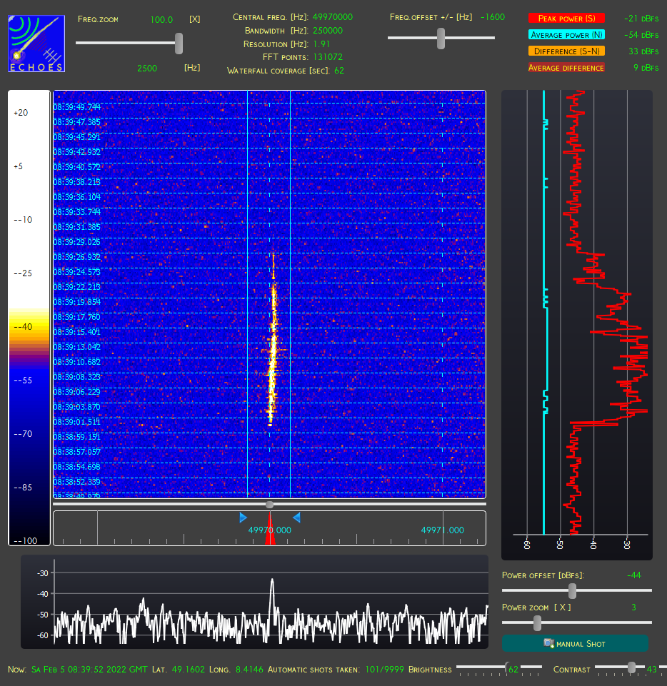

Am 5. ist das System von 18:17 bis 22:30 ausgefallen.
Event nr.
101​
Date
05/02/2022
UTC time
08:39:22.213
Unix timestamp (seconds since 01/01/1970)
1644050362.588
Tune [Hz]
49971600
Bandwidth [Hz]
250000
Central frequency [Hz]
49970000
Lowest frequency displayed[Hz]
49968750
Highest frequency displayed[Hz]
49971250
Zoomed bandwidth displayed[Hz]
2500
Resolution step [Hz]
1,90735
Threshold behavior
automatic​
Upper threshold [%]
65​
Lower threshold [%]
45​
Upper threshold [dBfs]
14,1073​
Lower threshold [dBfs]
12,3973
Range from [Hz]
49969875
to [Hz]
49970125
Event state
Raising front​
Event peak
Falling front
Maximum peak (S) [dBfs]
-33,1299
-21,1897
-45,1821
Average peak [dBfs]
-46,5602
-27,5145
-34,2291
Noise (N) [dBfs]
-55,0698
-54,765
-55,0909
(S-N) [dBfs]
21,9399
33,5753
9,90879
Average(S-N) [dBfs]
8,50967​
27,2505​
20,8619​
Maximum peak frequency [Hz]
49970005
49970022
49970039
Standard deviation
0,241045
0,35103
0,216151
Lasting [mS]
11262
21762
Frequency shift [Hz]
-39​
Area covered by echo[FFT points]
1183​
Area interval [FFT points]
11004​
Total number of peaks
111​
LOS Speed [m/s]
23​
Event nr.
114​
Date
05/02/2022
UTC time
09:22:21.684
1644052942.106
Tune [Hz]
49971600
Bandwidth [Hz]
250000
49970000
49968750
49971250
2500
1,90735
Threshold behavior
automatic​
Upper threshold [%]
65​
Lower threshold [%]
45​
14,9612​
13,1477
Range from [Hz]
49969875
to [Hz]
49970125
Event state
Raising front​
Event peak
Falling front
-29,3701
-14,3956
-44,7481
Average peak [dBfs]
-46,0174
-41,2075
-34,6249
Noise (N) [dBfs]
-55,151
-54,9764
-55,0003
(S-N) [dBfs]
25,7809
40,5809
10,2523
Average(S-N) [dBfs]
9,1336​
13,769​
20,3754​
49970016
49970006
49970016
Standard deviation
0,335818
0,504236
0,198274
Lasting [mS]
767
24938
-16​
1879​
12576​
131​
LOS Speed [m/s]
-10​

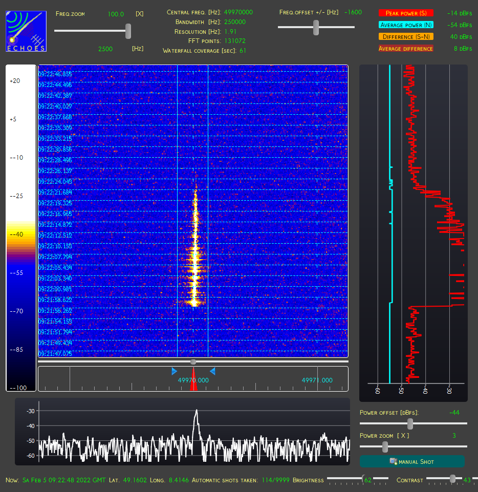

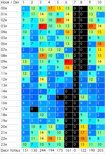

AM 5. gab es diese zwei Bremsspuren.
Gruß Thomas
Guten Morgen,
vom 6.2 ca. 16:30 Uhr UT bis 8.2. um ca.11:30 Uhr UT hatte ich kein Echo. Möglicherweise war der Sender außer Betrieb.
Gruß Thomas
Guten Morgen,
der Sender in Doubes arbeitet wieder.

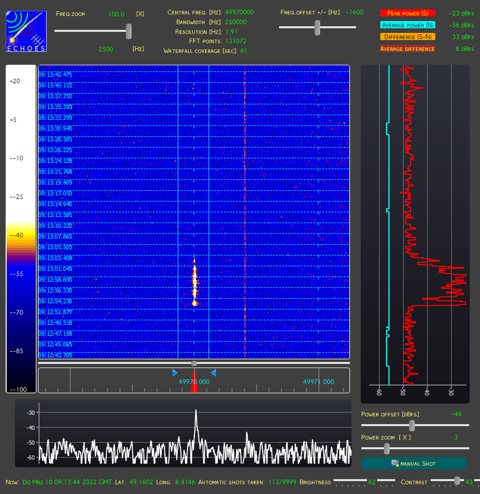

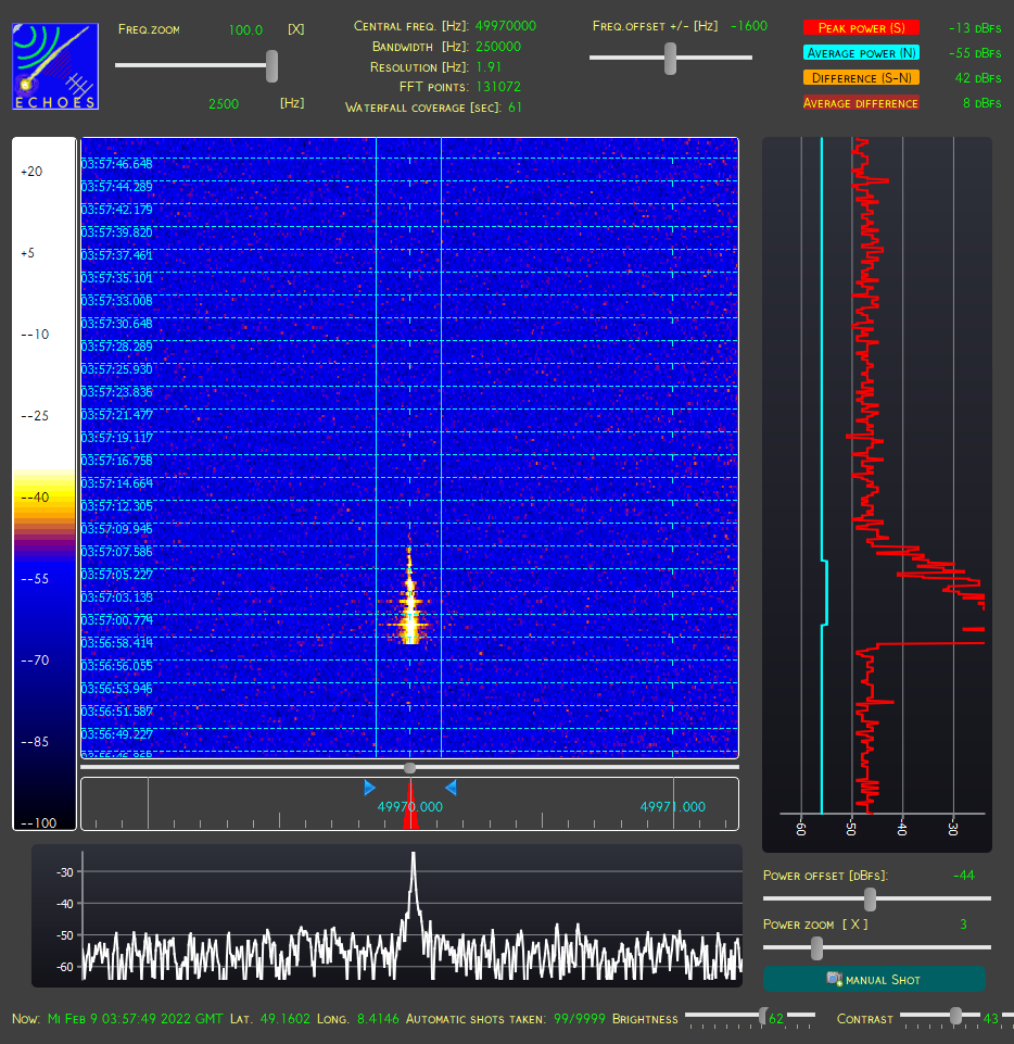

Leider ist m 10. mein System von 18:30 bis 21:30 Uhr UT ausgefallen.
Am 9. hab ich 10 und am10. nochmal 5 Einschläge lauter als 30 dBfs registriert. Sind da ein paar abstürzende Blechbüchsen dabei?
Event nr.
99​
Date
09/02/2022
UTC time
03:57:07.586
1644379028.008
Tune [Hz]
49971600
Bandwidth [Hz]
250000
49970000
49968750
49971250
2500
1,90735
Threshold behavior
automatic​
Upper threshold [%]
65​
Lower threshold [%]
45​
14,8594​
13,0582
Range from [Hz]
49969875
to [Hz]
49970125
Event state
Raising front​
Event peak
Falling front
-21,8313
-13,523
-46,5267
Average peak [dBfs]
-47,3137
-35,5037
-34,4153
Noise (N) [dBfs]
-56,2964
-55,9886
-56,1658
(S-N) [dBfs]
34,4651
42,4655
9,63908
Average(S-N) [dBfs]
8,98274​
20,4849​
21,7505​
49970003
49970001
49970045
Standard deviation
0,358509
0,538142
0,18453
Lasting [mS]
1858
9733
-45​
650​
4978​
46​
LOS Speed [m/s]
-12​
Am 9. Februar ist dieser mit 42,2 dBfs der lauteste gewesen.
Gruß Thomas

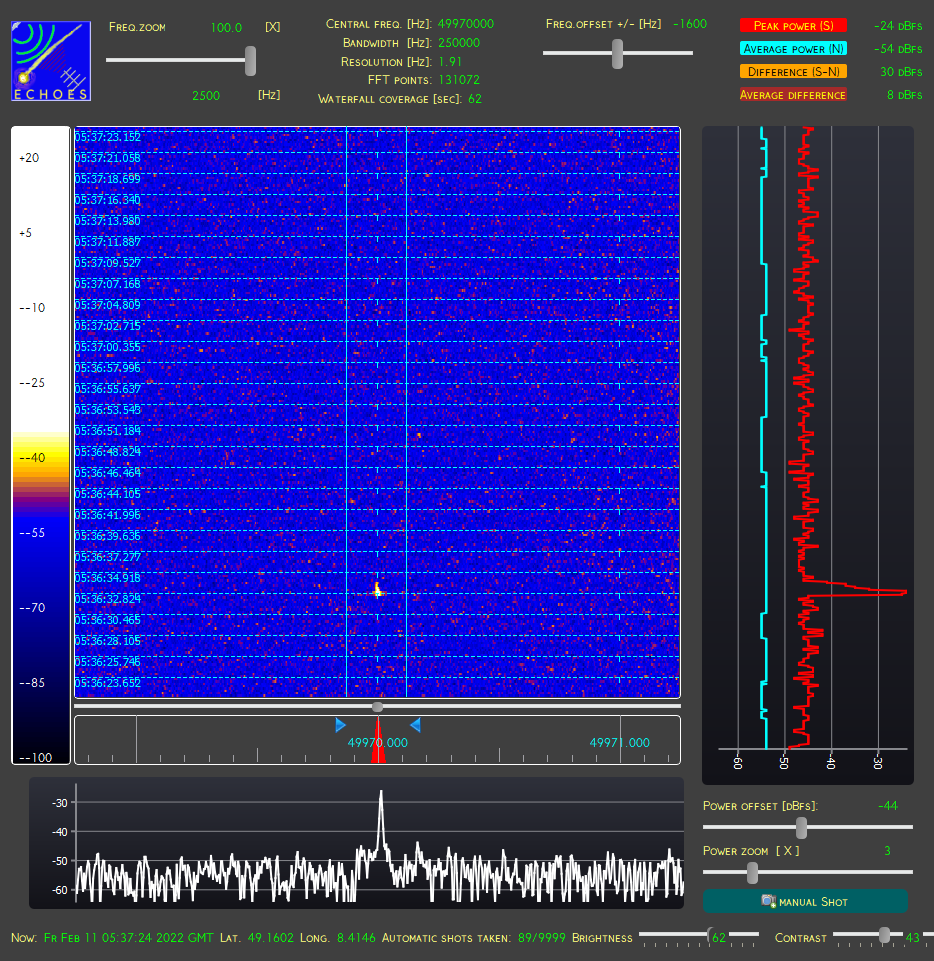

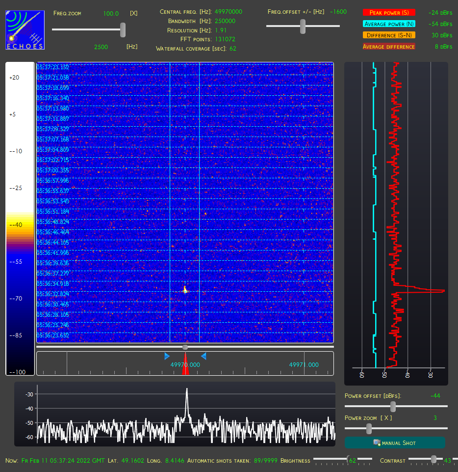

Am 11. ist das System von 11:53 bis 14:44 Uhr UT ausgefallen.
Am 11. Februar hab ich nur einen Einschlag lauter als 30 dBfs registriert.

IMO hat am 11. um 18:04 Uh UT eine Feuerkugel über der Zentralschweiz registriert. Mein System hat dagegen nichts. Das liegt entweder an der Antenne, die mit dem Stab in die Richtung zeigt oder Die Erdkrümmung/Bebauung hat die Sicht verdeckt.
Gruß Thomas

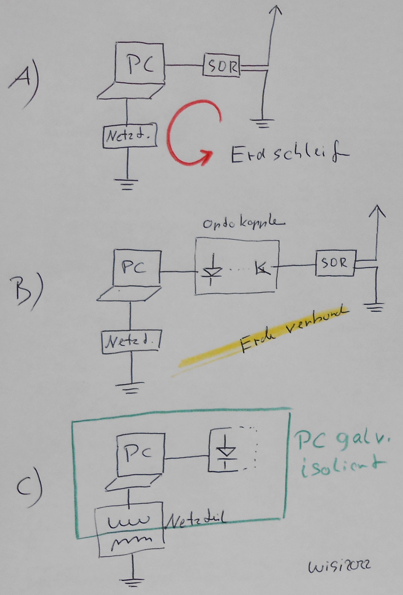

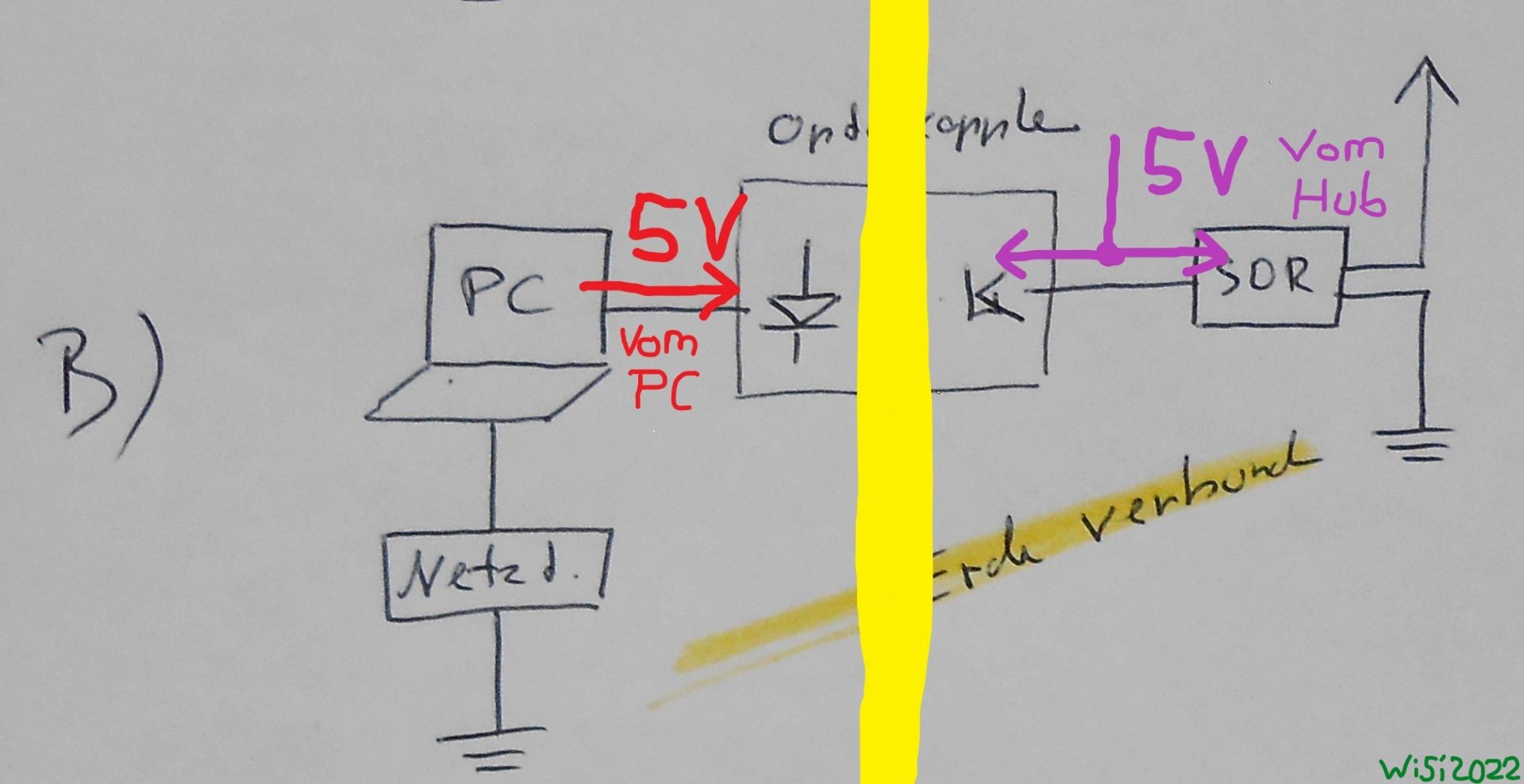

Guten Tag.
Thomas, du könntest den Rechner mit einem USB-Optokoppler galvanisch vom Rest der Anlage trennen.
Die gibts für ein paar Euro beim großen Fluss.
Wenn du jetzt mit dem Ohmmeter vom PC (zB an einer USB-Buchse) gegen Erde misst, hast du vermutlich Durchgang. Nach Einbau des Optokopplers wäre der PC vom SDR Dongle isoliert. Die SDR-Dongle Seite braucht dann natürlich ein eigenes Netzteil.
Hier bei Reichelt gibt es einen etwas besseren. Dort steht auch eine Erklärung dabei.
Kannst ja mal deinen Computerdoktor fragen…

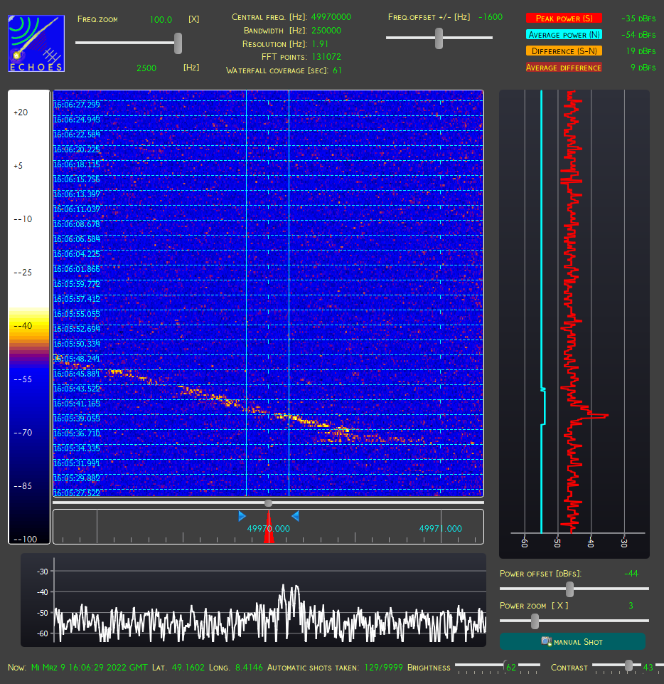

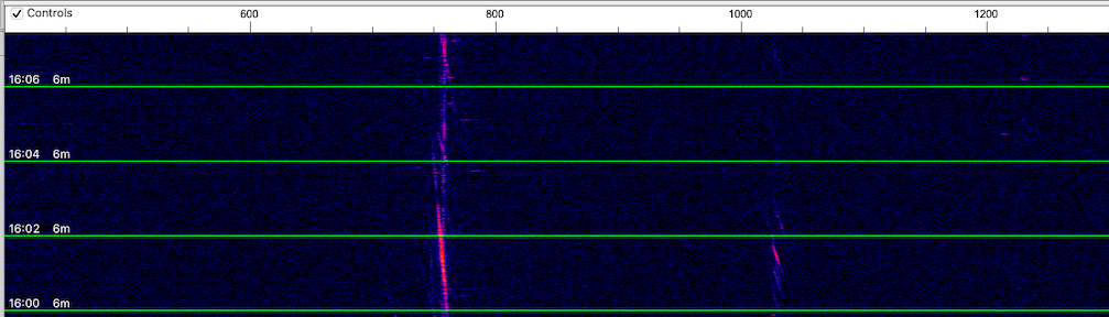

Hallo in die Runde,
so schön, wie die Trennung in GRAVEs und BRAMSe wegen der Ordnung ist, so schwierig ist es für mich, im "richtigen" Thread zu antworten. Ich hoffe einfach mal, dass die Aktiven und Interessenten in beiden Fäden mitlesen (es gibt ja dann noch ein paar mehr...).
Im Graves-Thread habe ich was zum Thema IMO-Sichtungen geschrieben (bin aber nicht eitel genug, ihn hierher zu kopieren)
Beim oben (von Thomas?) genannten IMO 1046 (1102_18.04 UT) über Süddeutschland / Schwyz lag ich leider noch nicht auf der Lauer, zu früh am Tage.
IMO 1058 (1202_19.03 UT) in der gleichen Richtung habe ich kein Signal.
Deutlich habe ich IMO 1057 1202_23.40 UT) mit Trajektorie von Rotterdam bis Amsterdam (!!!), auch bei GRAVES. Bild siehe Nachbarthread.
Wie sehen denn die beiden vermuteten "Rückkeulen " von Graves aus ?
Kann man hier irgendwie auf andere (eigene und fremde) Beiträge verlinken/verweisen? Danke für einen kurzen Hinweis (ja ich weiß, RTFM :whistle:)
Schöne Grüße
Matthias

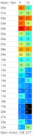

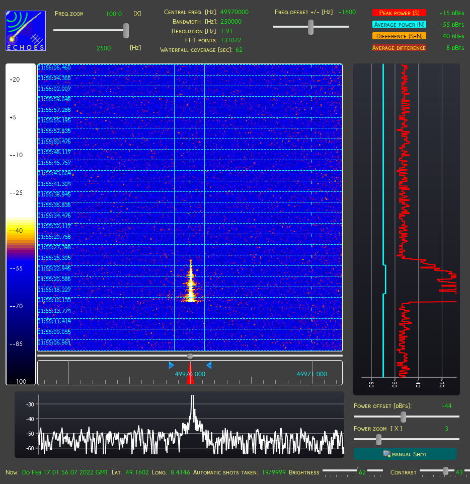

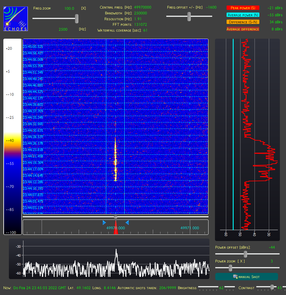

Guten Morgen,
Am 12. gab es 5 Einschläge lauter als 30 dBfs. Gestern waren es 6 obwohl das System von 15 bis 17:30 gestreikt hat.
Event nr.
243​

Der war der lauteste.

Gruß Thomas
Guten Morgen,
Gestern ist das System von 18:00 bis 22:15 Uhr UT ausgefallen.
Die ersten Brocken für die Weiterentwicklung sind bestellt und werden demnächst eintreffen.
IMO hat gestern um 0: 29 Uhr UT eine Feuerkugel über dem westlichen Bodensee registriert. Ich nicht.
Gruß Thomas
Guten Morgen,
Gestern ist das System von 14:23 bis 19:30 Uhr UT ausgefallen.
Am 15. und 16. gab es je einen Einschlag lauter als 30 dBfs.
Gruß Thomas
Guten Morgen,
Gestern ist das System von 8:12 bis 19:30 Uhr UT ausgefallen.
Ein USB-Hub mit eigener Stromversorgung ist eingetroffen und an die Wand geschraubt. Er bekommt seinen Strom wie der PC über den SUV-Block. Muß nur noch den Dongle umstecken. Der Optokoppler ist bestellt.
Vorgestern gab es 3 Einschläge mit einem S_N über 30 dBfs-
Event nr.
19​
Date
17/02/2022
UTC time
01:55:24.258
1645062924.695
Tune [Hz]
49971600
Bandwidth [Hz]
250000
49970000
49968750
49971250
2500
1,90735
Threshold behavior
automatic​
Upper threshold [%]
65​
Lower threshold [%]
45​
14,7152​
12,9315
Range from [Hz]
49969875
to [Hz]
49970125
Event state
Raising front​
Event peak
Falling front
-20,5614
-15,7492
-43,3606
Average peak [dBfs]
-46,4342
-44,6136
-31,6202
Noise (N) [dBfs]
-55,4536
-55,3404
-55,1245
(S-N) [dBfs]
34,8921
39,5912
11,7639
Average(S-N) [dBfs]
9,01934​
10,7268​
23,5043​
49970010
49970008
49970008
Standard deviation
0,431412
0,47616
0,215458
Lasting [mS]
219
9187
-8​
630​
4716​
49​
LOS Speed [m/s]
37​
Gruß Thomas

Hallo Thomas,
im Moment hast du Fall A).
Fall B)
Wenn du den PC und SDR mit der gleichen Stromversorgung betreibst, hast du zwar keine Erdschleife mehr, aber das ist noch keine galvanische Trennung.
Vielleicht reicht das aber schon.
Anzustreben ist Fall C), eine echte galvanische Trennung.
Viele Grüße,
Wilhelm

Guten Morgen,
Am 23. gab es 6 laute Einschläge und am 24. nur einen mit mehr als 30 dBfs.
Die Feuerkugel am 23. um 20 Uhr UT über der schwäbischen Alb hab ich nicht registriert.
Gruß Thomas
Guten Morgen,
An beiden Tagen gab es je einen Enschlag mit mehr als 30 dBfs.

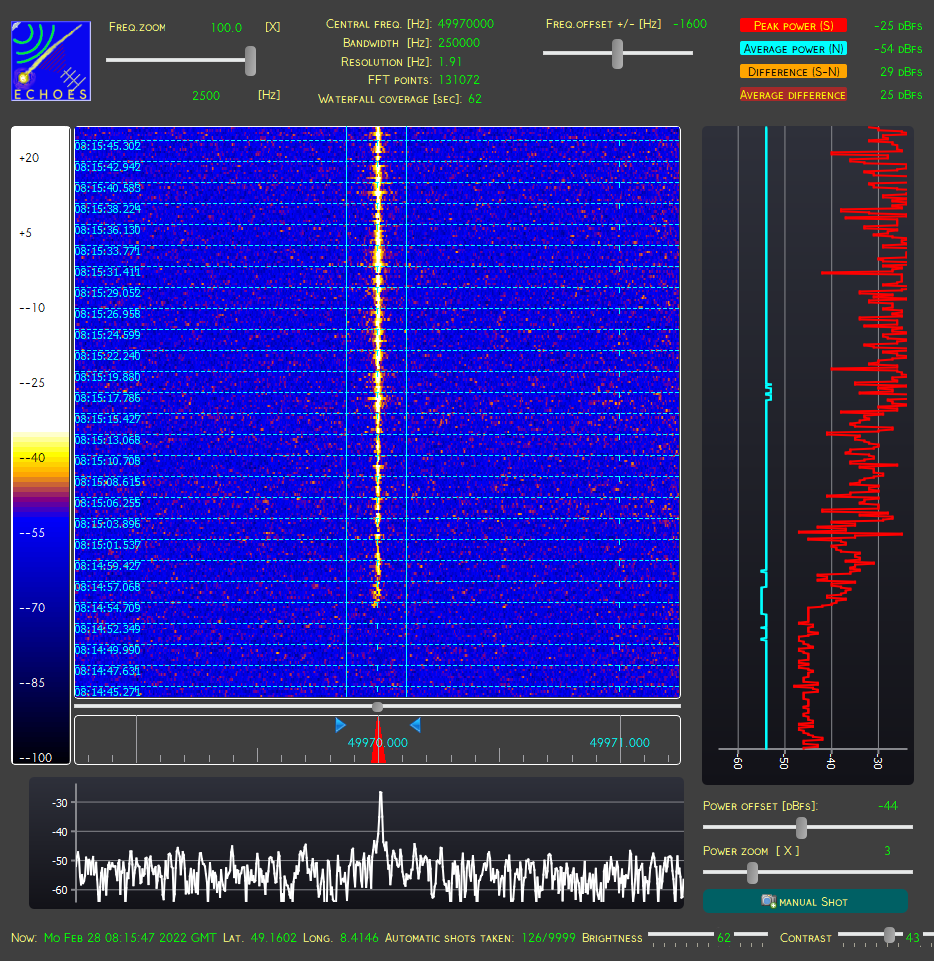

Guten Morgen,
Am 28. gab es zwei und am 1.3. drei Einschläge mit mehr als 30 dBfs
Event nr.
126​
Date
28/02/2022
UTC time
08:14:59.177
1646036099.537
Tune [Hz]
49971600
Bandwidth [Hz]
250000
49970000
49968750
49971250
2500
1,90735
Threshold behavior
automatic​
Upper threshold [%]
65​
Lower threshold [%]
45​
26,2581​
23,0753
Range from [Hz]
49969875
to [Hz]
49970125
Event state
Raising front​
Event peak
Falling front
-37,4982
-31,3635
-37,9068
Average peak [dBfs]
-44,5809
-38,4652
-37,9697
Noise (N) [dBfs]
-55,0756
-54,8999
-54,906
(S-N) [dBfs]
17,5774
23,5364
16,9993
Average(S-N) [dBfs]
10,4947​
16,4347​
16,9363​
49970005
49970003
49970005
Standard deviation
0,211391
0,250625
0,22249
Lasting [mS]
3937
4155
-5​
39​
1703​
7​
LOS Speed [m/s]
-29​
Am 28. um 08:15 Uhr UT gab es diese Bremsspur.
Gruß Thomas

Hallo Thomas,
welchen Optokoppler hast du?
Du musst sicherstellen, dass beide USB Ein/Ausgänge des Optokopplers mit 5V versorgt werden. Auf der PC-Seite kommt der Saft vom PC, auf der Dongle-Seite muss der Hub b.z.w. das Netzteil auch den USB Port des Optokopplers mit Strom versorgen, s. Anhang.
Viel Erfolg und viele Grüße,
Wilhelm

Hallo Wilhelm, ich weiß nicht, wie ich herausfinden kann, ob von neuen Hub her auch Strom zum Optokoppler kommt. Es ist der von dir empfohlenen.
Gruß Thomas
Hallo Thomas,
Also hast du den von Reichelt.
Versuch mal so ein Kabel. Das gibt es z.B. beim großen Fluss.
Vorne, in die USB Buchse, steckst du den SDR-Dongle.
Den mittleren USB Stecker steckst du in den Optokoppler in „Device“.
Über das Kabel mit den roten Stecker kommt 5V von einem USB Netzteil oder von deinem USB-Hub.
Die andere Seite des Optokopplers („Host“) verbindest du direkt mit dem PC.
Für die GRAVES Fans: GRAVES hatte gestern von 13-14 Uhr UTC Sendepause.
Viele Grüße,
Wilhelm
Nachtrag:
Das hier kann USB3.
Guten Morgen,
Gestern gab es 3 Einschläge lauter als 30 dBfs
Event nr.
129​
Date
09/03/2022
UTC time
16:05:40.366
1646841940.741
Tune [Hz]
49971600
Bandwidth [Hz]
250000
49970000
49968750
49971250
2500
1,90735
Threshold behavior
automatic​
Upper threshold [%]
65​
Lower threshold [%]
45​
13,9461​
12,2557
Range from [Hz]
49969875
to [Hz]
49970125
Event state
Raising front​
Event peak
Falling front
-36,3942
-35,7444
-46,8104
Average peak [dBfs]
-46,2114
-45,4754
-43,4885
Noise (N) [dBfs]
-54,8175
-54,7591
-54,8027
(S-N) [dBfs]
18,4233
19,0147
7,99226
Average(S-N) [dBfs]
8,60617​
9,28367​
11,3142​
49970073
49970092
49969900
Standard deviation
0,261651
0,236948
0,167222
Lasting [mS]
329
1860
100​
131​
1048​
4​
LOS Speed [m/s]
-1​

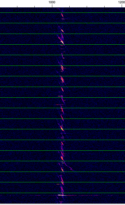

Dann gab es um 16:05 Uhr UT dieses merkwürdige Signal. Hat wer eine Idee, was das sein könnte?
Wilhelm, Danke für den Tip.
Gruß Thomas
Guten Morgen, Thomas,
das ist schon ein seltsames Signal.
Erst mal mein Bild für die Zeit (ich war außer Haus, sonst läuft die Aufnahme tagsüber nicht immer)
Da ist bei Dourbes (Mite) nichts zu sehen, eventuell könnte der Fliegenschiss bei Ieper zeitlich passen, bei Graves auch ein Strichlein etwas später, aber auch ein Strich "längs", also entlang der Zeitachse.
Soweit also erst mal Fehlanzeige. Bei meinen Graves-Vergleichen mit Eberhard ist es eher die Regel als die Ausnahme, dass wir ein kräftiges Signal von einem beim anderen (Achtung, bei mir ist der Empfängerstandort immer noch NL) nicht sehen. Aber bei Dourbes sollte das doch etwas anders sein. Da kann es doch eigentlich keine Nebenkeulen geben, nur einen Kegel nach oben, und wenn einer reinfliegt (was auch immer) blitzt es bei allen rundum.
Generell sehe ich seit einiger Zeit verstärkt "Flugzeugspuren" bei Dourbes (siehe hier kurz vor 16.02 UT) und gelegentlich auch bei Ieper. Ich habe das auf die derzeit vorherrschende Windrichtung (Anflug auf Luxemburg von Westen?) und generell erhöhte Flugaktivität geschoben.
Aber deine Kurve passt nicht so richtig in das Bild. Sie hat zwar angedeutet die S-Form, aber die Frequenzänderung ist extrem hoch. Ich komme auf eine Dopplergeschwindigkeit von 750 m/s entlang der Verbindungslinie zwischen Dir und dem Sender. Die Flugzeuge mit der Geschwindigkeit sind aber in der Regel zu klein für eine Reflexion. BTW: Was ist eigentlich die LOS Speed, die dein Programm ganz unten auswirft?
Bleibt natürlich noch eine Möglichkeit: Irgendwo ist ein Funkamateur oder einer im Tarnanzug auf die Taste getreten und hat zufällig die Frequenz durchgestimmt. Sprich: Es war ein Störsignal, zufällig oder absichtlich auf der Frequenz.
Es bleibt spannend.
Schöne Grüße
Matthias
Hallo Thomas,
normalerweise sollte man sich nicht selber antworten ;-((
Aber ich habe heute am Tag mal mit Blick auf das obenstehendes Thema nur Dourbes (49970 kc) laufen lassen. Da ist eine Menge eigenartiger Kurven dabei, zu meiner Überraschung auch eine "Satellitenkurve", die ich bisher nur Graves zugeschrieben habe (ganz unten).
So ganz kann ich aus meinem Zeitmaßstab keine Dauer ableiten, aber eine gewisse Ähnlichkeit mit deiner Kurve wäre schon da.
Schöne Grüße
Matthias
Guten Morgen Matthias,
LOS Speed bedeutet die relative Geschwindigkeit im Bezug euf die Ligne of Sight (LOS) also die Linie Sender-Empfänger. In diesem Fall hat sich das nDing zuerst auf diese Linie zu- und dan wegbewegt, wie man an Hand der maximum peak frequency sehen kann.
Gruß Thomas
Guten Morgen,
Getern ist das System von 9:31 bis 17:43 Uhr UT ausgefallen.
Am 10. gab es einen und am 11 zwei Einschläge mit mehr als 30 dBfs.

Vorgestern wurde dieser schöne Kracher registriert. Mit einer LOS Speed von 32 m/s ganz schön schnell. Wie man an den Peak Frequenzen ablesen kann, ist er auf die Linie Sender - Empfänger zu geflogen, hat sie überquert und sich dann entfernt.
Gruß Thomas

Es ist nur ein Einschlag lauter als 30 dBfs registriert worden.
