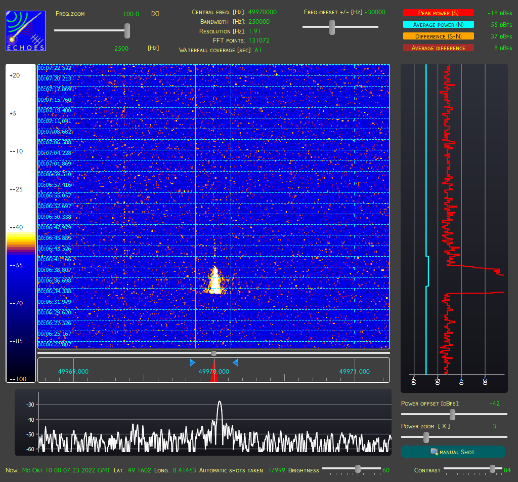

Guten Mörgen,
Vorgestern ist der Wasserfall um 09:32:45 Uhr UT stehen geblieben und hat einen auf Barcode gemacht. Gestern um 05:16 Uhr UT hab ich neu gestartet. Darum taugt die Statistik nichts.
Event nr.
1​
Date
10/10/2022​
UTC time
00:06:39.323​
Unix timestamp (seconds since 01/01/1970)
1665360399.713​
Tune [Hz]
50000000​
Bandwidth [Hz]
250000​
Central frequency [Hz]
49970000​
Lowest frequency displayed[Hz]
49968750​
Highest frequency displayed[Hz]
49971250​
Zoomed bandwidth displayed[Hz]
2500​
Resolution step [Hz]
1,90735​
Threshold behavior
automatic​
Upper threshold [%]
65​
Lower threshold [%]
45​
Upper threshold [dBfs]
14,8478​
Lower threshold [dBfs]
13,0481​
Range from [Hz]
49969875​
to [Hz]
49970125​
Event state
Raising front​
Event peak​
Falling front​
Maximum peak (S) [dBfs]
-27,8325​
-18,0639​
-46,6206​
Average peak [dBfs]
-46,4313​
-42,8135​
-24,7848​
Noise (N) [dBfs]
-55,4655​
-55,2951​
-54,5747​
(S-N) [dBfs]
27,6329​
37,2313​
7,95408​
Average(S-N) [dBfs]
9,0342​
12,4816​
29,7898​
Maximum peak frequency [Hz]
49970031​
49970012​
49969997​
Standard deviation
0,391372​
0,40985​
0,170536​
Lasting [mS]
0​
546​
6015​
Frequency shift [Hz]
3​
Area covered by echo[FFT points]
522​
Area interval [FFT points]
3144​
Total number of peaks
27​
LOS Speed [m/s]
17​
Trotzdem has ich diesen Kracher eingefangen. Man erkennt das erhöhte Hintergrundrauschen.
Gruß Thomas

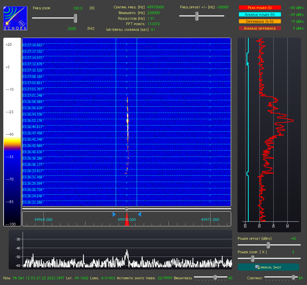

Guten Morgen,
Gestern gab es nur einen lauter als 30 ndBfs.
dafür aber einen Raucher
Event nr.
22​
Date
12/10/2022​
UTC time
03:26:34.614​
1665545194.989​
Tune [Hz]
50000000​
Bandwidth [Hz]
250000​
49970000​
49968750​
49971250​
2500​
1,90735​
Threshold behavior
automatic​
Upper threshold [%]
65​
Lower threshold [%]
45​
16,5754​
14,5663​
Range from [Hz]
49969875​
to [Hz]
49970125​
Event state
Raising front​
Event peak​
Falling front​
-40,6394​
-40,6394​
-46,0052​
Average peak [dBfs]
-49,6425​
-49,6425​
-46,424​
Noise (N) [dBfs]
-59,0357​
-59,0357​
-58,8992​
(S-N) [dBfs]
18,3963​
18,3963​
12,894​
Average(S-N) [dBfs]
9,39316​
9,39316​
12,4752​
49969993​
49969993​
49970008​
Standard deviation
0,225459​
0,225459​
0,187416​
Lasting [mS]
0​
0​
2297​
-8​
22​
1048​
2​
LOS Speed [m/s]
37​

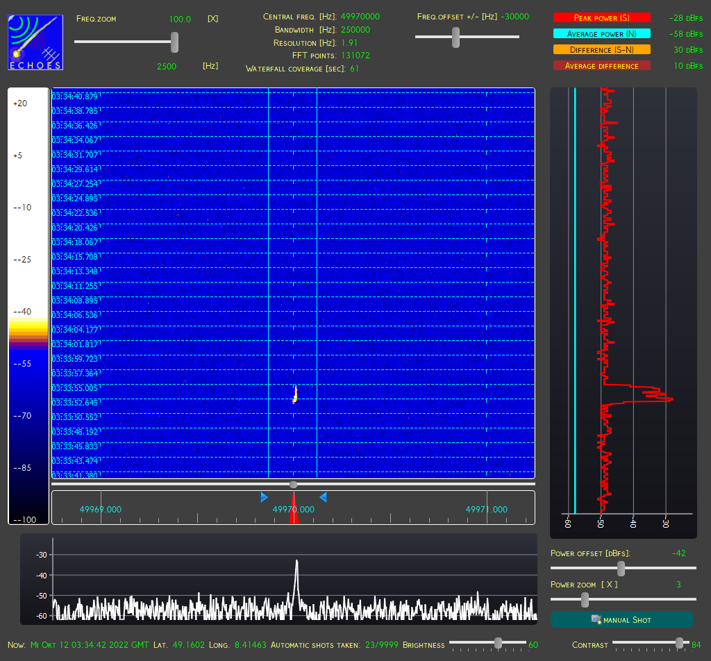

und einen Kracher
Event nr.
23​
Date
12/10/2022​
UTC time
03:33:55.005​
1665545635.411​
Tune [Hz]
50000000​
Bandwidth [Hz]
250000​
49970000​
49968750​
49971250​
2500​
1,90735​
Threshold behavior
automatic​
Upper threshold [%]
65​
Lower threshold [%]
45​
16,1416​
14,185​
Range from [Hz]
49969875​
to [Hz]
49970125​
Event state
Raising front​
Event peak​
Falling front​
-29,156​
-28,1759​
-49,0844​
Average peak [dBfs]
-48,5354​
-47,2683​
-39,5122​
Noise (N) [dBfs]
-58,7998​
-58,7712​
-58,6003​
(S-N) [dBfs]
29,6438​
30,5953​
9,51595​
Average(S-N) [dBfs]
10,2645​
11,5028​
19,0882​
49970008​
49970006​
49970010​
Standard deviation
0,259755​
0,25729​
0,197951​
Lasting [mS]
0​
216​
2624​
-10​
62​
1441​
15​
LOS Speed [m/s]
25​
Gruß Thomas

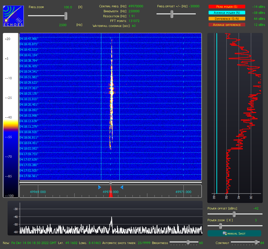

Guten Morgen,
Vorgestern gab es einen und gestern drei Einschläge lauter als 30 dBfm
Event nr.
25​
Date
14/10/2022​
UTC time
04:18:45.607​
1665721125.997​
Tune [Hz]
50000000​
Bandwidth [Hz]
250000​
49970000​
49968750​
49971250​
2500​
1,90735​
Threshold behavior
automatic​
Upper threshold [%]
65​
Lower threshold [%]
45​
15,3035​
13,4486​
Range from [Hz]
49969875​
to [Hz]
49970125​
Event state
Raising front​
Event peak​
Falling front​
-37,9473​
-14,638​
-45,7518​
Average peak [dBfs]
-49,34​
-24,2608​
-38,9759​
Noise (N) [dBfs]
-58,7037​
-58,2418​
-58,7173​
(S-N) [dBfs]
20,7564​
43,6038​
12,9655​
Average(S-N) [dBfs]
9,36368​
33,981​
19,7414​
49970005​
49970016​
49970016​
Standard deviation
0,1979​
0,404657​
0,174516​
Lasting [mS]
0​
25155​
44295​
-16​
2607​
22270​
441​
LOS Speed [m/s]
-10​
Gestern gab es Besuch im Rauchersalon: 69 Sekunden!
Gruß Thomas

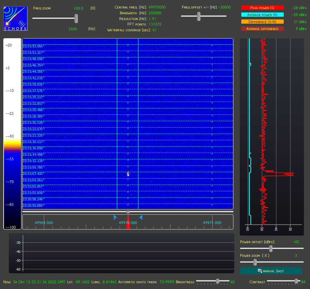

Guten Morgen,
Gestern gab es einen Brösel lauter als 30 dBfs, einen kurzen lauten.
Event nr.
73​
Date
15/10/2022​
UTC time
23:31:07.952​
1665876668.327​
Tune [Hz]
50000000​
Bandwidth [Hz]
250000​
49970000​
49968750​
49971250​
2500​
1,90735​
Threshold behavior
automatic​
Upper threshold [%]
65​
Lower threshold [%]
45​
15,3164​
13,4599​
Range from [Hz]
49969875​
to [Hz]
49970125​
Event state
Raising front​
Event peak​
Falling front​
-28,0058​
-28,0058​
-49,5333​
Average peak [dBfs]
-49,7003​
-49,7003​
-43,608​
Noise (N) [dBfs]
-59,0387​
-59,0387​
-58,9659​
(S-N) [dBfs]
31,0329​
31,0329​
9,43258​
Average(S-N) [dBfs]
9,33839​
9,33839​
15,3579​
49969999​
49969999​
49969987​
Standard deviation
0,284335​
0,284335​
0,188122​
Lasting [mS]
0​
0​
1860​
13​
61​
1048​
14​
LOS Speed [m/s]
-7​
Ich staune immer wieder über die Datenflut, die Echoes aus einem Signal extrahiert.

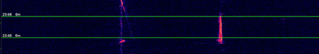

Moin Thomas,
Der um 23.46 UT wäre ein guter Anwärter auf den Sieger bei der Länge. Muss genau über Ieper gewesen sein, Graves hat ihn in NL, nicht in Spanien.
Dourbes (49970 kHz) hatte ich leider nicht laufen.
Schöne Grüße
Matthias

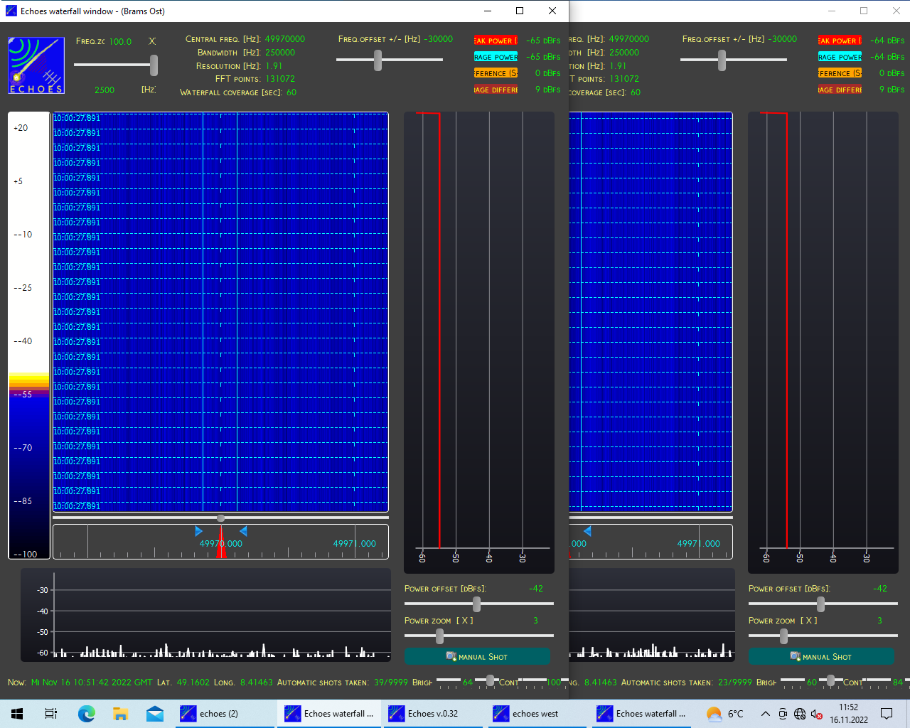

Guten Morgen,
Gestern Morgen 6:45n Uhr Ut hab ich auf einen zweiten Dongle mit der Ost-Antenne umgeschaltet.
Gestern hab ich auf dieser Antenne einen Einschlag mit mehr als 30 dBfs eingefangen.
Der war relativ kurz aber heftig.

Guten Morgen,
da bin ich wieder. Ich hatte eine bißchen Ärger mit einen Computercrash.
Inzwischen laufen zwei Instanzen.

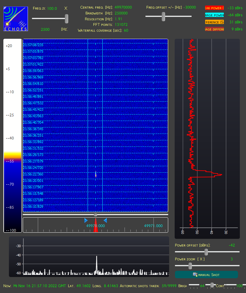

Zur Abwechslung mal wieder ein Barcodemuster auf beiden Wasserfällen
Gestern haben Beide Antennen gleich viel Overdense gezählt.
Uhrzeit SN-Wert
Ostantenne 11:53:25,007 32,2652
Westantenne 11:53:25,185 27,3706
Uhrzeit SN-Wert
Ostantenne 21:56:23,142 30,492
Westantenne 21:56:23,235 28,174
Was bis jetzt auffällt ist: Mal sind die Zeiten auf Ost mal auf West früher. Die Signalstärken sind jedes Mal auf Ost stärker.
Gruß Thomas

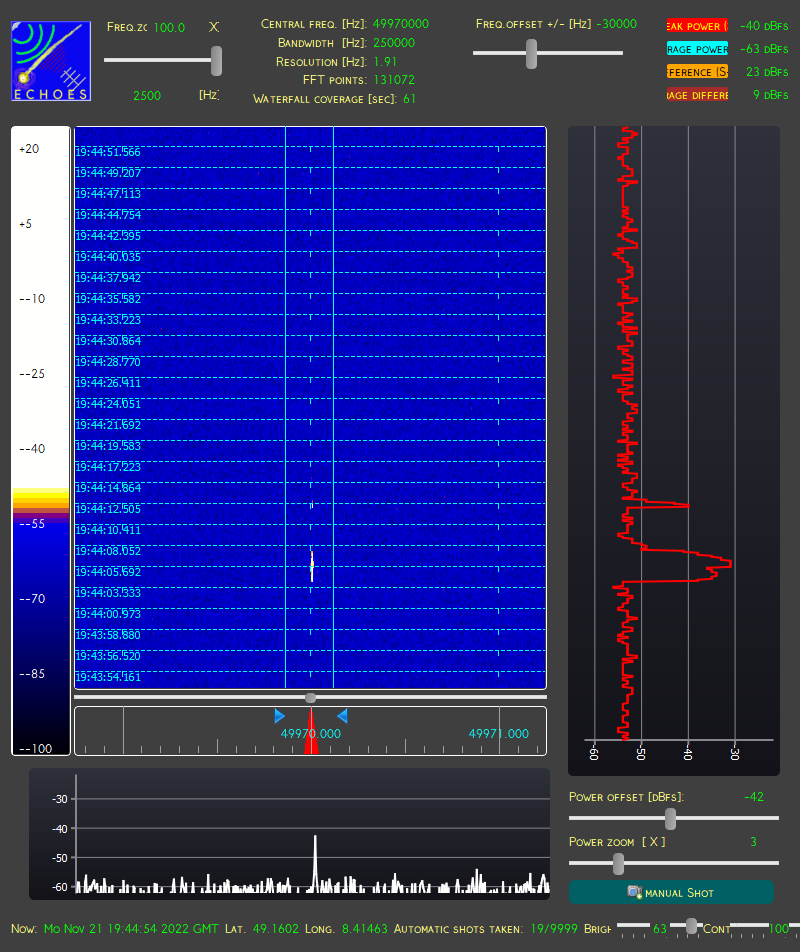

Der schönste Einschlag war gestern um 19:44 Uhr UT
Event nr.
19​
Date
21/11/2022​
UTC time
19:44:08.052​
1669059848.458​
Tune [Hz]
50000000​
Bandwidth [Hz]
250000​
49970000​
49968750​
49971250​
2500​
1,90735​
Threshold behavior
automatic​
Upper threshold [%]
65​
Lower threshold [%]
45​
15,2852​
13,4325​
Range from [Hz]
49969875​
to [Hz]
49970125​
Event state
Raising front​
Event peak​
Falling front​
-38,4041​
-31,065​
-50,961​
Average peak [dBfs]
-53,9675​
-45,5126​
-39,1988​
Noise (N) [dBfs]
-63,1885​
-63,3137​
-63,335​
(S-N) [dBfs]
24,7844​
32,2487​
12,374​
Average(S-N) [dBfs]
9,22097​
17,801​
24,1362​
49970010​
49970008​
49970008​
Standard deviation
0,23155​
0,268202​
0,209564​
Lasting [mS]
0​
1856​
3935​
-8​
91​
2096​
21​
LOS Speed [m/s]
37​
Das ist das Ergebnist auf der Westantenne.
Die Werte auf Ost und West:
Uhrzeit Ost 19:44:08,223 Und West 19:44:08,052
Signalstärke Ost34,2487 und West 32,2487
Gruß Thomas

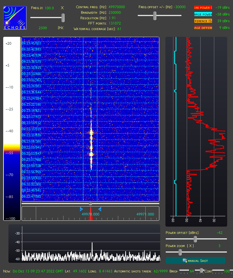

Der hier wurde auf der Ostantenne um 20:20:29,51Uhr UT mit 37,7403 dBfs registriert
und auf der Westantenne um 20:2029,93 Uhr UT mit 38,5984 dBfs.

Dieser wurde aus der Ostantenne um 09:08:05,95 Uhr UT mit 36,0398 dBfs
un auf der Westantenne um 09:08:06,12 Uhr UT mit 37,1364 dbfs registriert

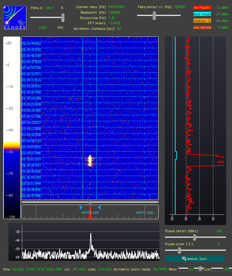

Der 02:19er hat auf Ost ein SD-N von 40,6692 und auf West von 42,075 dBfs gebracht.

Am 15.12.22 gab es noch einen Raucher um 9:23 Uh UT. Auf Ost waren es 39,6122 und auf West 25,9021 dBfs
Gruß Thomas

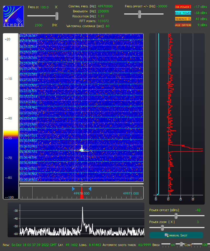

Davon war der um 05:36:52 am lautesten. Er hat es auf Ost auf 41,3066 und auf West auf 36,0608 dBfs gebracht
