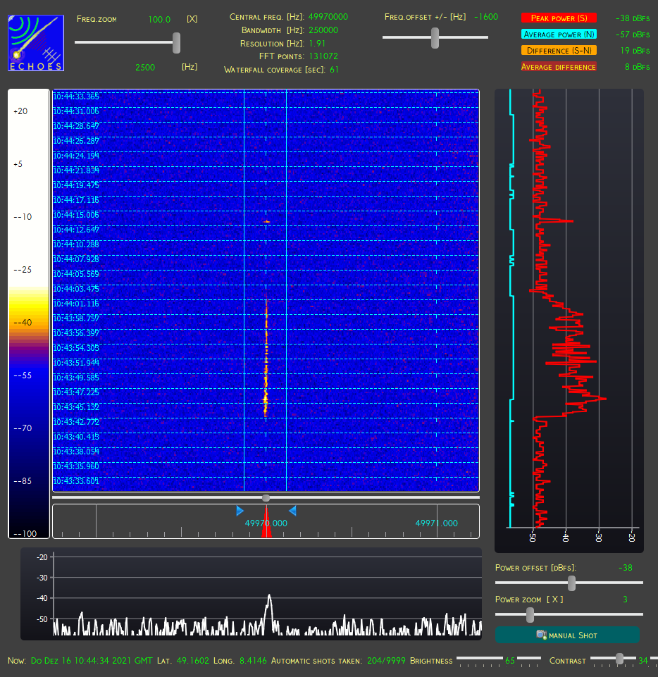

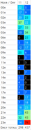

Und hier die Daten vom 12. Dez.
und hier die Daten vom 15. und 16. Dez
Event nr.
204​
Date
16/12/2021
UTC time
10:44:00.850
Unix timestamp (seconds since 01/01/1970)
1639651441.256
Tune [Hz]
49971600
Bandwidth [Hz]
250000
Central frequency [Hz]
49970000
Lowest frequency displayed[Hz]
49968750
Highest frequency displayed[Hz]
49971250
Zoomed bandwidth displayed[Hz]
2500
Resolution step [Hz]
1,90735
Threshold behavior
automatic​
Upper threshold [%]
65​
Lower threshold [%]
45​
Upper threshold [dBfs]
14,1787​
Lower threshold [dBfs]
12,46
Range from [Hz]
49969875
to [Hz]
49970125
Event state
Raising front​
Event peak
Falling front
Maximum peak (S) [dBfs]
-40,9283
-28,3709
-45,0943
Average peak [dBfs]
-48,5509
-41,2568
-40,1971
Noise (N) [dBfs]
-57,0981
-56,9882
-56,9437
(S-N) [dBfs]
16,1699
28,6173
11,8495
Average(S-N) [dBfs]
8,54723​
15,7313​
16,7466​
Maximum peak frequency [Hz]
49969995
49969995
49970003
Standard deviation
0,194212
0,312303
0,218716
Lasting [mS]
2624
17827
Frequency shift [Hz]
-3​
Area covered by echo[FFT points]
345​
Area interval [FFT points]
9039​
Total number of peaks
60​
LOS Speed [m/s]
-17​
Bei diesem Einschlag liegt die Peakfrequenz in der Rising Front und dem Event Peak unterhalb der Zentralfrequenz. Also bewegt sich der Brösel von der Linie Sender-Empfänger weg, oder?
In der Falling Front liegt sie aber darüber. Treibt da der Höhenwind die Ionisationswolke wieder auf diese Linie zu?
Gruß Thomas

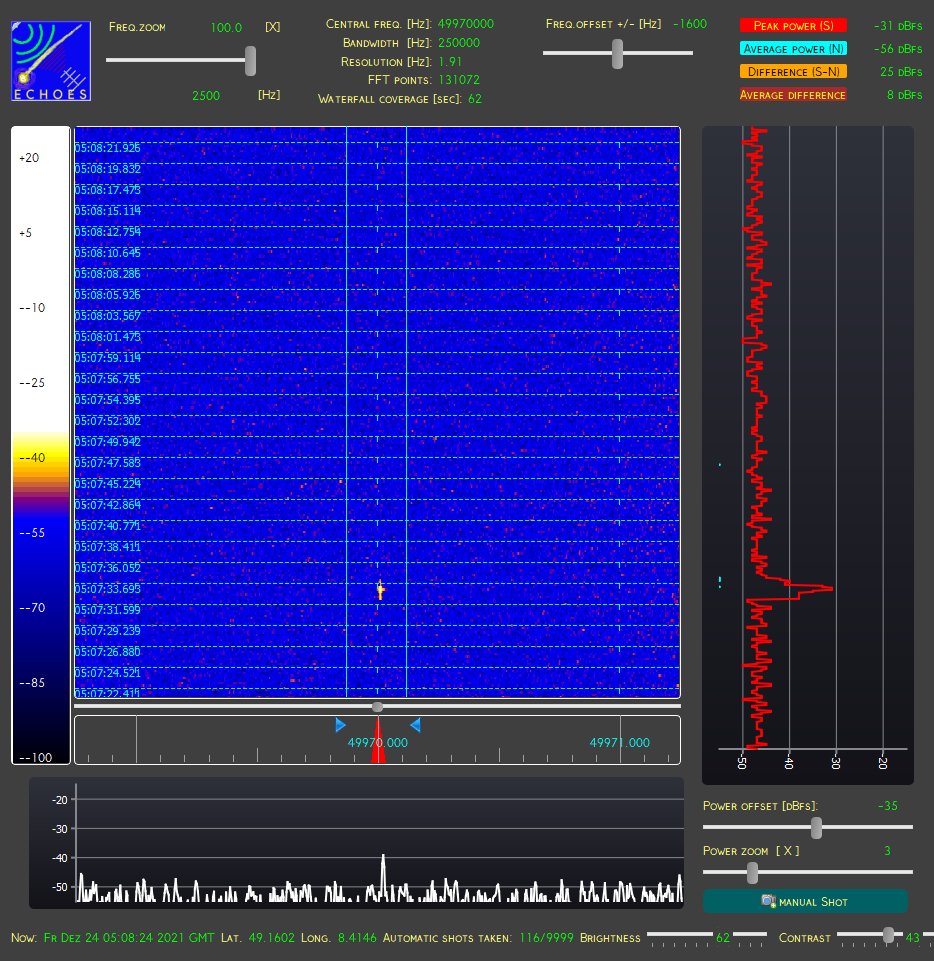

Guten Morgen,
Event nr.
116​
Date
24/12/2021
UTC time
05:07:34.208
1640322454.614
Tune [Hz]
49971600
Bandwidth [Hz]
250000
49970000
49968750
49971250
2500
1,90735
Threshold behavior
automatic​
Upper threshold [%]
65​
Lower threshold [%]
45​
14,9693​
13,1548
Range from [Hz]
49969875
to [Hz]
49970125
Event state
Raising front​
Event peak
Falling front
-38,7521
-31,2859
-42,947
Average peak [dBfs]
-47,3393
-44,9505
-42,4874
Noise (N) [dBfs]
-56,1578
-56,0151
-55,9852
(S-N) [dBfs]
17,4058
24,7291
13,0382
Average(S-N) [dBfs]
8,81854​
11,0646​
13,4978​
49970012
49970012
49970010
Standard deviation
0,224169
0,246227
0,210838
Lasting [mS]
984
2078
-10​
43​
1179​
7​
LOS Speed [m/s]
25​
Dieser Brösel scheint zerbrochen zu sein, wie der Anstieg der Signalstärke im Peak nahelegt. Er hat sich mit 25 m/s auf die Linie Sender-Empfänger zubewegt.
Frohe Weihnachten Thomas

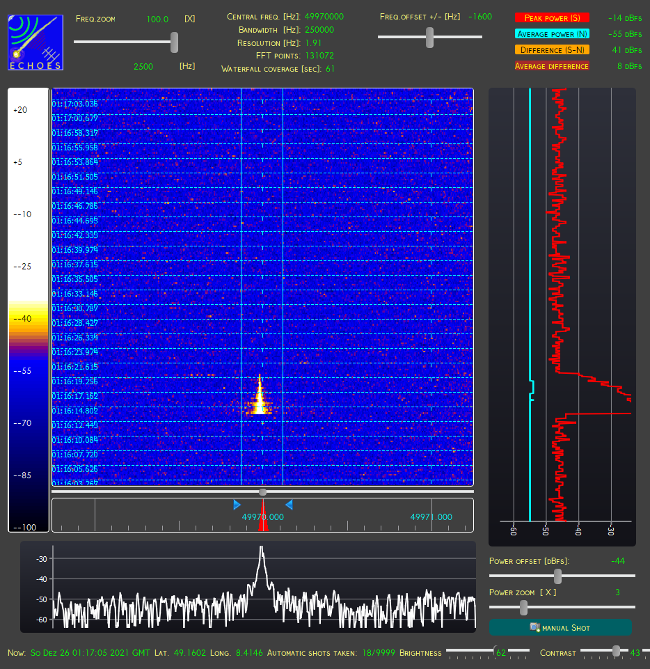

Guten Morgen,
Gestern gab es zwei sehr laute Einschläge.
Event nr.
18​
Date
26/12/2021
UTC time
01:16:20.052
1640481380.459
Tune [Hz]
49971600
Bandwidth [Hz]
250000
49970000
49968750
49971250
2500
1,90735
Threshold behavior
automatic​
Upper threshold [%]
65​
Lower threshold [%]
45​
15,8501​
13,9289
Range from [Hz]
49969875
to [Hz]
49970125
Event state
Raising front​
Event peak
Falling front
-17,9915
-14,5343
-46,5295
Average peak [dBfs]
-45,8784
-43,2379
-31,0442
Noise (N) [dBfs]
-55,7063
-55,466
-55,1832
(S-N) [dBfs]
37,7148
40,9316
8,65369
Average(S-N) [dBfs]
9,82784​
12,2281​
24,139​
49969980
49969982
49970018
Standard deviation
0,475294
0,457416
0,170125
Lasting [mS]
329
6345
-18​
380​
3275​
24​
LOS Speed [m/s]
-22​

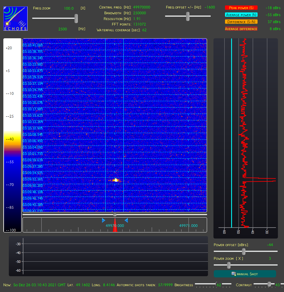

Event nr.
57​
Date
26/12/2021
UTC time
03:09:52.561
1640488192.968
Tune [Hz]
49971600
Bandwidth [Hz]
250000
49970000
49968750
49971250
2500
1,90735
Threshold behavior
automatic​
Upper threshold [%]
65​
Lower threshold [%]
45​
14,3909​
12,6465
Range from [Hz]
49969875
to [Hz]
49970125
Event state
Raising front​
Event peak
Falling front
-26,4551
-18,3767
-46,8674
Average peak [dBfs]
-46,9422
-43,2995
-39,924
Noise (N) [dBfs]
-55,6122
-55,5772
-55,5069
(S-N) [dBfs]
29,1571
37,2005
8,63953
Average(S-N) [dBfs]
8,66997​
12,2777​
15,5829​
49970022
49970014
49969921
Standard deviation
0,376497
0,403973
0,20684
Lasting [mS]
546
1312
79​
141​
786​
6​
LOS Speed [m/s]
-41​
Der Nr. 57 hat sich schnell mit 41 m/s auf die Linie Sender-Empfänger zubewegt
Gruß Thomas
