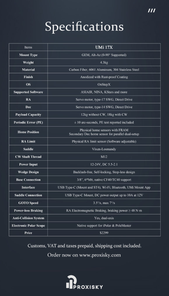

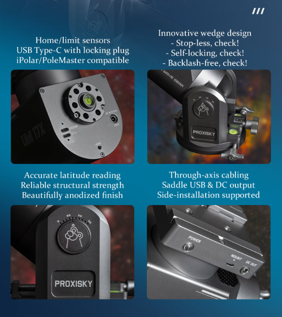

Und es wurde eine 17X für 2299$:
  • Physical home sensors with FRAM
  • Physical RA limit, adjustable via software
  • Additional Dec physical home sensor for parallel dual-setup
  • Anti-collision system (ACS)

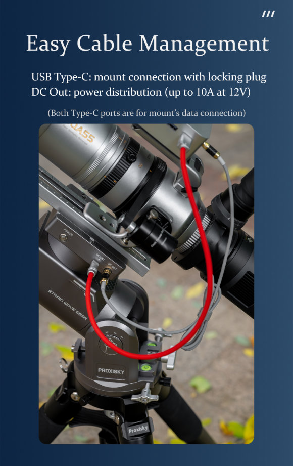

  • Through-axis cabling with mount USB connection and up to 10A output at 12V
  • USB Type-C with locking plugs for maximum durability

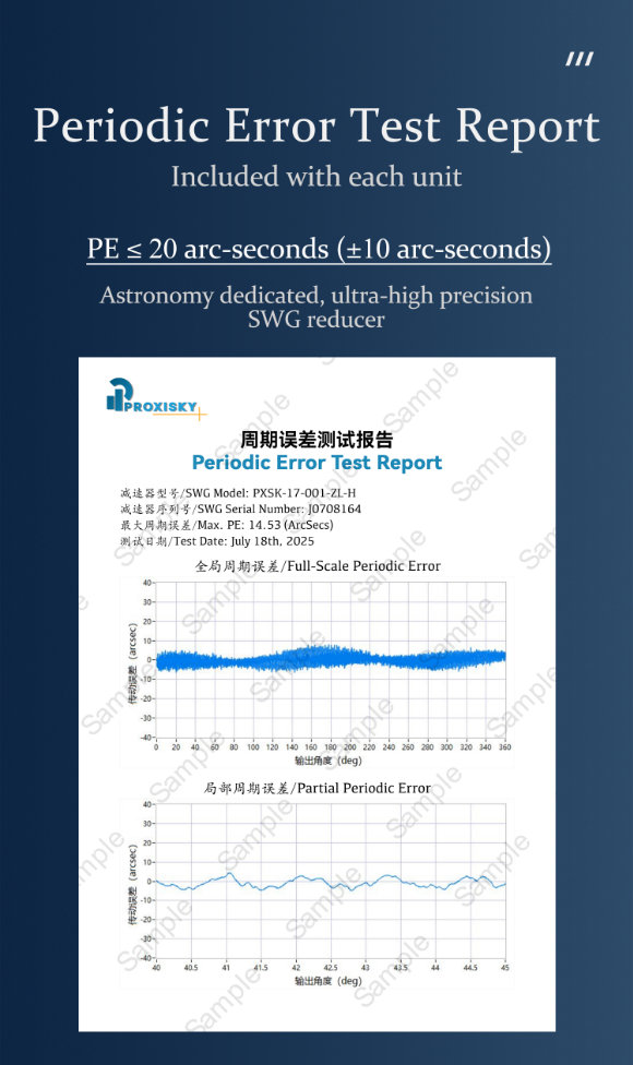

  • ±10” periodic error SWG combined with precision servo motors, PE test report included with each unit
  • World's first stop-less, self-locking and backlash-free wedge design on a SWG mount
